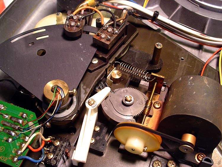

If it's an automatic turntable, you'd be shocked how much is under the hood in all those mechanisms. Possible something is binding up somewhere down there, or in the tonearm bearings. Does it coincide with the rotation? One thump every time around? Or faster than that, or random?
Why, whatever do you mean? <G>
And yah ... it's possibly just a simple adjustment. Most tables will have a screw that's accessible from the top that adjusts both the set down and pick up position. Try turning the screw a bit and see if that cures the noise, AND the arm still sets down properly. On the PL-530, I'd assUme that's the lil hole under the arm rest ...
** Good idea to keep your hand on the cue lever when adjusting the drop position in case the stylus drops off the record. Make sure you run several cycles to make sure the new position "locks" in properly.
