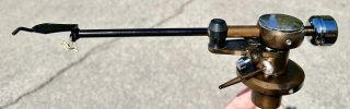

Does anyone recognize this tonearm?
It came off a Clear Audio Compact Innovation TT in bad need of restoration, but having problems recognizing this tonearm. It's not a uni-pivot, has a fixed head shell, VTA set screw on base, No markings on it. Arm is metal, anti-skate mechanism by lift arm has a broken string attached to it. The tonearm cable is hardwired with no DIN plug.
with the three screws underneath bottom of TA base to secure mounting.
Any of you of analog sleuths know this TA ???

I answered the query at Vinyl Engine - some aspects look like Helius or Logic products, but the wide variation of metals and finishes makes me suspect it is a DIY lash up by someone with better machining skills than me and a different idea of aesthetics than I have.

Thank you for the reply. You nailed it! And one I would never have guessed. I believe it looks to be the Helius Designs "Scorpio 4" Tonearm. Thank You!
A pretty rare bird, now I just have to find out how to repair the anti-skate string and where it attaches to, because of you I was able to find the manual for it, but no mention or diagram of the anti-skate string set up. Will first service it, and get it dialed in. Don't think this TA is worth much, but you helped a lot.

Helius seemed to often use brass or bronze parts, which is why I though of them. I can't get past the silver dome thing which looks like the part you buy at the hardware store to cover the hole for the sprayer hose in the sink if you have the sprayer integrated with the faucet,

You're pretty spot on, on that
