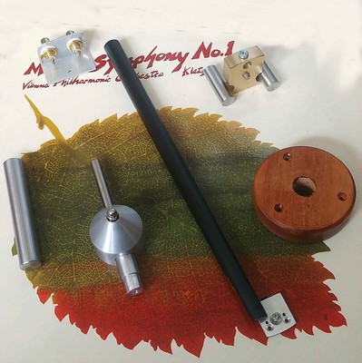

Hi, Take a look at the this 12.5'' kit arm on E/B, easy assemble, under $500.
This was the last review posted for it:
''What can I say about the arm? It's spectacular! I was astonished at the sound transformation from my favorite records. Improved clarity, dynamics, and sonic depth. Transient tones previously missing have now stepped forward and revealed themselves. Julie London singing 'Cry Me a River" was a revelation. With my old Rega RB300 arm her voice was somewhere in the hallway; with the TA arm it was like she walked into the room and was now standing 8 feet from me. I couldn't be happier with the results.''
