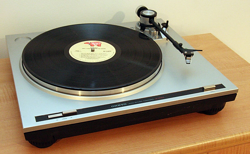

I few days ago I bought an Onkyo CP-1000A TT. I set it up yesterday, and was impressed by what I had gotten for $10! Not knowing much about TTs and vinyl, I used the same tracking force people had recommended I use for my other TT (a Dual 504), that is 1.25g. That worked just fine. Today I worked out that the CP-1000A is basically the same critter as the CP-1200A, which allowed me to download a manual from Vinylengine. The manual recommends a tracking force of 2g for the standard cartridge, which I am pretty sure my TT still has installed. (The manual says nothing about the cartridge, mine says ADC Series 1). I tried that and find no noticeable improvement. Should I go back to 1.25g? :headscrat
I am guessing the less the tracking force, the less wear is put on stylus and record. So you really want to use as little as you need to achieve the sound you want. Is am correct in that thinking?

Cartridge tracking force is generally determined by the cartridge, not the turntable. Go to this link http://www.cartridgedb.com/ and look up you cartridge, with any luck they will have a recommended tracking force for your cartridge. An analog audiophile friend of my suggested that you want to track close to the heavier side recommended force to extract the most information from the recording. I've also read that you should consider the condition and cleanliness of the lp. My 2 cents worth.
First of all, Frank, congratulations on the $10 score!
The tracking force is dependent on the cartridge and stylus, not the turntable. There's no way to know what cartridge was originally on this. I believe for this you can use 1.5g. Yes, less force means less record wear to a degree. But too little force and the arm is easily pushed from side to side potentially causing groove damage. A good rule of thumb is about 2/3 to 3/4 the way to the high end. So for example, the possible tracking force range for Shure's best elliptical carts is .75 to 1.5g and the recommended force is 1.25g.
Incidentally, this ADC cartridge has a conical tip and is not the best for sound reproduction. This Onkyo has the advantage of having a low mass arm which is a good match for many of the low cost, popular cartridges available today.
Many thanks for your input, guys. For the time being I've put it back to 1.25g, because I actually imagine hearing a little crackle when I put it higher. It's definitely there at 2g.
