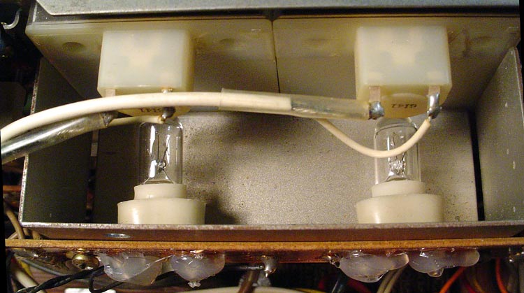

Having recently aquired 4 TU417's and hardly a lamp still working, I thought I would do a bit of research to see if there was a suitable replacement bulb that didn't require modification to the rubber bases (the wedge base replacement option, which also makes it hard to use the original blue tint lamp shrouds), and maintained an OEM look.
This is my solution -
A bit if fiddling, and here is a replacement bulb
And fitted to the rubber holder, no mods needed
And fitted to the Tuner - the bulb diameter is slightly larger (11mm compared to the originals at 10mm), so the shrouds need a slight squeeze to get them on, but is is fairly easy to get them into place over the new bulbs.
Lights on
And a couple of front panel shots
The bulb spec is 7.5V 220ma, 1000 hour and 1 MSCP output. The measured voltage in situ is 7.6VAC, so it is pretty close to the voltage spec of the lamp. The actual measured output of these alternative lamps is around 0.8- 0.9 MSCP

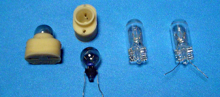

As part of the research I tried the 8V 250ma globes from vintage electronics, but found them to be a tad dim at arounbd 0.5 MSCP output. I also tried an 8V 300ma wedge globe from a local supplier, and it was around 3 MSCP (6 times brighter than the 250ma one). The 417 I have changed the globes in did not have one working original, so I could't measure the output of an original lamp for comparison purposes, but hopefully one of the other 417's I have will have a working lamp.
It helps if you have one of these when doing this sort of work
A Lumasphere for measuring the light output from small light sources (it measures in Lumens - divide by 12.57 to get MSCP)
Now.... where did the bulbs come from......
They are "removed" from a standard G 3 1/2 Lamp (CEC part number 51, and they are also available from CML I think under the same generic number). The "removal" takes a couple of minutes, and then I tack soldered some 30awg wire wrap wire on to the ends of the existing wires to extend them.

I experimented with a Bi-Pin 8v 80mA bulb which was fairly simple to construct, but DID NOT give off enough light. However I thought it might give someone else a brainstorm on a different approach. The pins are thick enough that they hold well being inserted from the top. See Photos.

Went in another direction with my QRX 9001. That has five of these lil rascals, two behind the signal meters, and three to light the front panel. I tried the bayonet type bulbs shown in the bottom right but those didn't allow much clearance behind the meters and were definitely too tall for the dial lamps.
Final solution was the LEDs ... those are commonly available for automotive interior lamps.
Warm white, high intensity. The bayonet base just pulls right off once you pry the wires away from the sides.
Rated 12v, but that usually means they'll fire at anywhere from 7v - 16v. These work well as a simple swap into the original Sansui holders, and no discernable flicker. 8v feed from the chassis, but at that level, the high intensity bulbs are just about perfect. The light from the three bulbs to the left of the faceplate (taped over in the top pic to test) bounces around inside the glass to light the entire dial area, and these give a nice even wash all the way across. Bonus - the original blue shields clip right over the LED bulbs and the color is extremely close to original if not spot on. The Sansui puts out AC for the bulb circuit, but no discernible flicker that you might sometimes get from a DC bulb, so no other mods required ... just plug em in.
PS ... lower left, you can see I trimmed one of the Sansui bulb holders for a bit more clearance, and ended up doing the same with the rest. I also added a spot of hot glue inside each to seat the LEDs better.

@sKiZo ~ could you give us a little more detail on the LEDs you used? Did you buy them in bayonet form? (like this) and remove the LEDs, or did you find a source of just the LEDs themselves? Have searched but no joy finding the latter.
Wow ... the thread lives on. <G>
For whatever reason, this pic disappeared in my original post.
You can see these pop right off the base - just bend the wires straight and slide them out. Here's the exact bulbs I got:
https://www.amazon.com/gp/product/B00DZXMURU/ref=oh_aui_search_detailpage?ie=UTF8&psc=1
As mentioned earlier, these gave me almost exactly the same light output and color temp of the original incandescent globes in my Sansui. No issues a year later.
PS ... I stand corrected ... these are technically "wedge" type bases, not bayonet.
