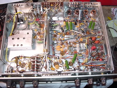

One good thing about the Sherwoods is they used a lot of good parts, and often don't need a lot besides filter caps. They're also a rather shallow chassis, so no "layers" of crap to dig through. Despite the small size, they're probably not really any worse to deal with than any of the others. To be frank about it, my S-7000 is easier than my Fisher 600 inside.
Dunno about the 600 (that's one of the simulcast stereo receivers with a vacuum tube HV rectifier?), but the 400 and 500 are, I'd opine, the easiest to service vacuum tube receivers extant.

400:
undersidenoveau by Mark Hardy, on Flickr
500C:
DSC03163 by Mark Hardy, on Flickr
I can pull out my S-8000 and snap a photo of the underpinnings some time if I get up the gumption.
Sherwood S8000IV by Mark Hardy, on Flickr
Don't get me wrong -- I like the Sherwoods, but everything's jammed so tight I worry about heat, too.
The 600 is indeed the simulcast unit. Under the hood its constructed almost like 2 units bolted together. Its not, but the front part is on sort of a "step" up into the RF deck with the preamp circuits. Its a bit deep up there, and the parts are layered in somewhat. In the back its more flat, but its just very busy. It also has dual vacuum rectifiers, one for the power amp and one for the tuner and preamp. Its got a number of those brown turd caps up there that ought to be changed, and some of them are wound underneath of other parts. Not impossible to work on, its just not the most fun experience either. Not to say that the S-7000 is roomy, just that since it needed less under the chassis, its a bit less annoying to work on. It does have more can capacitors, all of which I removed to re-stuff, a process I simply do not enjoy doing.
The 400 and 500 look somewhat less packed. I would imagine the S-8000 to be a bit less full than my 7000 is too, since it has no AM tuner to contend with.
