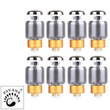

Viva Tubes sells an octet of the Psvane KT-88T-MKII (coated) right now they are 25% off retail. I use the 6SN7 / CV181 version of these in my office system- they have a slightly warm presentation:
