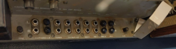

After a few years listening to my SA-9100's, I got to upgrading my listening room (room treatments) and my speakers (OLA->Monitor Audio Silver 100's) and have since been fiddling withe the componentry. Long story short, after having tried various setups I love how things sound with the sa-9100 amp between the schiit saga preamp and my monitor audios.
That said, I was bottom fishing the bay and got an sa8500-ii clean but wouldn't power on a year ago, and an sa-9500 that had been mistreated and left for dead. The first one just seemed neglected, but the second smelled like broken dreams Seemed like the her handler didn't even care enough to wrap her well, and looks like it got dropped on one of the cable management handles in shipping
I'd thought no power at all might be simple problem in the unregulated p/s part in the 1st unit. The 2nd unit, the seller said it clicked a second after turning it on, but no light came on. I'd guessed this might just be a lamp out. Turns out I was lucky on both. A tech fixed the former with a diode, and the latter didn't need a fix. Both amps make terrible popping, scratching, intermittent channels out in the pre-stage, but if separated and using a different pre work fine, though I haven't pressed my luck by listening to them long o hard.
So I'm interested in interviewing each of these amps between my schiit pre and my monitor audios. After the last ordeal with my 2nd sa-9100 where another tech had added workarounds, subbed wrong parts, reinstalled boards with resistor legs lifted out of circuit, I had sworn not to inflict audiokarma or myself to another repair, yet starting with working (kinda) units seem a more known quantity.
I'm not sure, but I feel like best practices have changed in the last 15 years, but I'm thinking, power supply board(s), amp board(s), main caps? I'm not sure from the threads I've read if this means all transistors or just the problem ones, all electrolytics with thoughtful substitution with film caps, and new trim pots. For my purposes, other than de-oxit I'd leave the pre stages alone for now?

I've been working on a receiver recently with a lot of popping and noise in the preamp. I had thought that it was a bad transistor or two on the tone board (and it may well have been a factor), but the big issue ended up being a bad speaker protect relay. It would just randomly arc and pop on its own, and do it consistently if I tapped it with my finger.
I bought a moldy old 9500 II at the end of last year. It worked but smelled like a mix of mildew and dirty ashtrays. It was a lot of work, but I love it now. You'll like your 8500 II once you get it going, I think. I have a 9500 as well and it's one of my favorites. Unique.
I am far from being an expert, so grain of salt... I have definitely been in the "replace everything!" camp for the most part, but this year I've been experimenting with just aligning and enjoying new equipment or recapping the electrolytics and replacing only the transistors on the bad list. That's worked pretty well for the equipment I've tried it on. As for your last question, if you're going to do it then I'd do all the boards. I usually replace the filter caps, but I don't think I've actually found a bad one yet though. YMMV.

Recapped 8500ii aws-113 that I'm guessing contains the protect circuit and power supply awh-051's amp boards - sounds good including the pre stage, but I'm only listening with headphones.
Are there draining resistors on these big caps or are mine just not holding a charge? Any current part numbers for the big caps sa-8500ii? All the #'s I see from the threads I look up seem out of stock.
I always use these in SA-9500ii's. Bump in voltage means they'll last longer.

After wrestling with an idle problem and then royally self inflicting some damage on an innocent amp board, the sa-8500ii is back among the living.
De-oxited contols, (I think) power and protect circuit, big caps and renewed amp bords. Eager to compare the amp stage to the sa-9100 amp stage and see if there's any audible difference.
By the way, I learned if you have a labeled bag of transistors, it doesn't mean there's not a different transistor in there to wreck your day if you don't verify.
