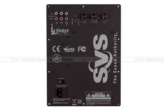

Have you tried eliminating the Y's and routing the signal into and out of the sub?
I believe your SVS sub has both in and out rca jacks.

Do you mean instead of using Y's use two separate cables? For a total of four cables?
Have you tried switching channels on the sub inputs and/or outputs? Since the crackling is in one channel.

If the old SVS and new SVS amp both have a problem, then it sounds like it may be a splitter issue or could be an issue in the SVS amps that have a sensor problem sensing a signal. This might be remedied if the auto turn-on circuit is disabled and the sub is left in an always on position and is plugged into the back of your receiver for power instead.
Since it tends to happen a couple days later, I would tend to look at the auto sensing circuit.
I spent several years and rebuilt a preamp circuit board several times because of a similar issue. Eventually I figured out it was an adapter cable! Change the cables/splitter just to rule them out.
If this is your sub, then it looks like it has high level input/output.
Yeah Y splitters
You cannot do this. SVS expects line level signal from BASS MANAGEMENT system, That system works like a crossover between preamp and power amplifier. So it gets two line level inputs from preamp, then filters low frequencies from both channels, merges them together and send to subwoofer. It then sends high frequencies from each channel to power amplifier driving main speakers. AV receivers do it all internally (in most cases digitally). If you want to keep all analog path, you need to buy subwoofer that has bass management circuit embedded inside its amplifier. So that it accepts two line level signals from preamp, and outputs two line level signals to power amp.

Yeah when I switch the problem switches to the other speaker
I hope I didn't make things more confusing. It looks like there is a model SD12-NSD that does not have high level input/output...
