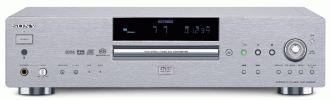

I have two DVP NS900V decks (both black), one DVP NS999ES (in silver), and one DVP CX777ES (also in silver), the 900 is my favorite, would like one in silver but they're at a premium. Purchased these about 8yrs ago none over $80, all still work flawlessly.
The 999 I use with the Kenny silver stack in the bedroom, the 900 in the media rm with all the black face equipment, the big carousel is in the living rm getting the most use.
If not familiar with these decks you need to look into the menu for the "attenuator", this will lower the output to a more friendly level with less distortion for 2-channel listening, especially with older gear.
There's been mention of the big carousels eating discs, I can see that happening if the belts are worn, new belts were $12 and easy enough to change in that cavernous interior.
It doesn't hurt that these are all such great looking decks to match their SQ.
Sony DVP NS900V (still want one in silver)
Sony DVP NS999ES
Sony DVP CX777ES
If you like the big carousel keep in mind it's HUGE and will need some real estate.
As for which sounds the best, my vinyl lol.
