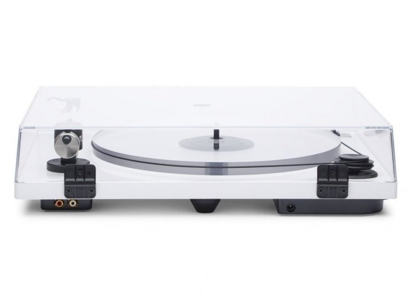

Turntable: U-Turn Orbit Plus (without the built in pre amp)

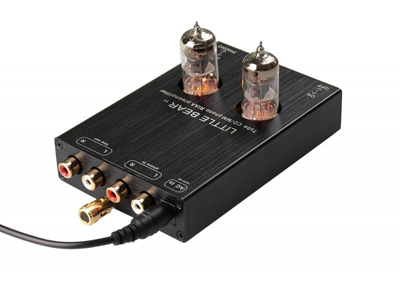

Pre Amp: Little Bear T7 Tube Phono Stage RIAA MM Turntable Pre-Amplifier &HiFi AUX Preamp

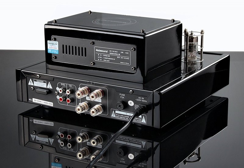

Amplifier: Nobsound MS-10D MKII Hybird Tube Amplifier with Bluetooth/USB/Headphone for Hi-Fi

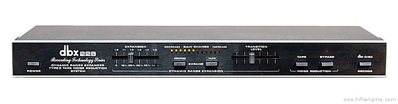

Dynamic Range Expander: DBX228 Type2 / disc noise reduction system & dynamic range expander.

You can use the 228 to expand between the T7 and amp and use the expander only. The unit will also decode dbx encoded discs and do noise reduction with a rec/play on tapes. You won't need those, yet.
Keep the transition so the yellow/red lights are centered and use the expansion until you hear the music breathing, a sign of too much exp. I would think the lower half would be good for most use more if you like it.
Can't imagine life without a dbx in da house. I've got a 3bx and love it.
Don't get too carried away with expansion ... moderation in all things, they say. I keep both transition and expansion around 1.3 with excellent results. Once you're in the general vicinity of where you need to be (and it will vary a bit with each system) you'll find very small tweaks can make or break the effect. Just listen in ... you'll know when it's "right".
And ya ...make sure you disengage the noise reduction. That's strictly for dbx encoded disks. Just plug the unit into a tape loop on your receiver and yer good to go.
