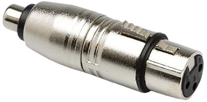

I would buy a quality used, US-made, stereo PA type crossover. DOD, BiAmp, BGW, Ashly, etc. all made pretty good ones. Just know if you go that route, you will have to make adaptor cords, as few of those used RCA inputs/outputs.
There is no need to buy or fabricate new cables. XLR to RCA adaptors are widely an inexpensively available.
Both types are available on Amazon.
Note: XLR female connections are exclusively for inputs. XLR male connectors are exclusively for outputs. This applies to cables and devices.
If you observe the back of any XLR equipped device you'll notice the outputs are male and the inputs are female. All XLR cables have a male and a female end. XLR cables are truly directional.
FWIW: My gear has a mix of RCA and XLR connectors. Adaptors work just fine for me.
With cables there is flexibility to wire them according to various needs. The adapters, while fine in many cases, do not allow flexibility if you need to work with pin 1/pin 3 or shielding issues.
