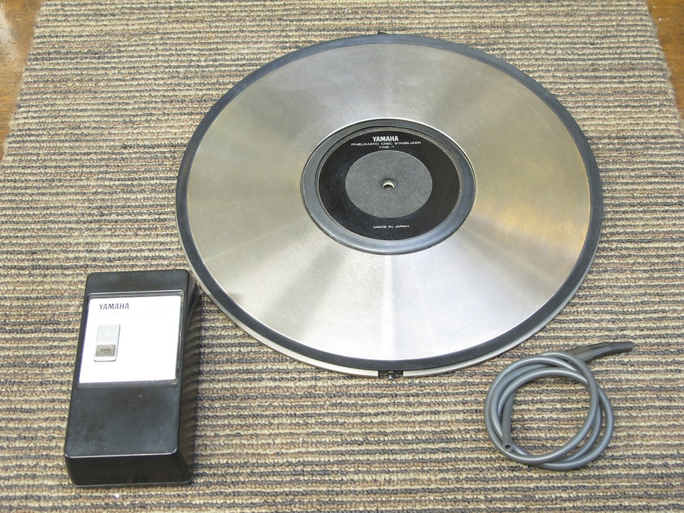

Yamaha YDS-1 disc stabilizer
Looks very similar as Audio Technica at 666
