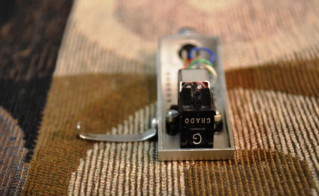

The first was a JVC JL-A40 - semi-automatic direct drive model from 1977. The description read: "It spins. No dust cover. Needs a stylus." From the photos, in addition to the missing dust cover, I could see it was also missing one of the control knobs and dusty as all get out, but what caught my eyes was the Grado cartridge. I've never owned, or even heard a Grado, but I've been wanting to give one try. I figured for 10 bucks, why not? Even if everything else is total trash, the headshell is probably worth at least that much.
Ok, I have no idea what Grado cartridge this is, or if it was original to the turntable. It looks like a Grado Black to me, but without the stylus, how can you tell? Was the Black around in 1977 when this turntable was made? Is this some older model Grado, or a Black (or similar) that was installed at a later date?
Here's some photos:
Can any of you Grado experts help me identify this bugger?
Now the real questions. Is it worth keeping and getting a stylus for it. It looks like the Grado Black (or possibly the Black 2) is the least expensive option at 50 bucks, but I've also read the many glowing reviews of the 8MZ stylus for $150. Is this cartridge compatible with, and worthy of, an 8MZ? Is it worth turning my $10 bargain into a $160 investment, or is my money better spent elsewhere?

Thanks for the reply. Can you tell if the cartridge in the photos is a Grado Black? I suspect it is, but don't really know how to tell for sure.
I have a local dealer that sells Grado cartridges. So, I could pick up a Black 2 stylus from them for 50 bucks. I've read several reviews that claim the Black 2 is a significant improvement over the original Black. I'm not familiar enough (at all) with the Grado products to understand if the magic is in the cartridge body or the stylus. If this is an original Black body and I put a Black 2 stylus on it, is it more likely to sound like a Black or a Black 2, or maybe somewhere in between?

If you remove the cartridge from the headshell, there should be a date code stamped on top. It might instead possibly be back by the pins. That will help you figure out what series it came from.
Thanks for the tip! There is a F04 stamped in the plastic above the pins. Is this the date code you are referring to? If so, what does it tell me? Does that mean it was made in February of 2004?
June 2004.
Ok, that would seem to align with my expectation that it's most likely a Grado Black (or maybe a Green or Blue) body.
If I put a Black 2 stylus on it, will it sound like a Black or a Black 2? Is this body worthy of a $150 8MZ stylus? Will it sound significantly better with an 8MZ than it would with a Black 2 stylus?

The internals of the new Black2 body are different from the earlier series, but I wouldn't expect that installing a new Black2 stylus will be an "upgrade."
IIRC, the bodies from that era with a "G" on the front are the basic model (Black, Blue, Silver) and the ones with "JG" are the premium models (Green Red, Gold).

I can't tell what Grado it is other than Prestige line, unfortunately. The only thing I can say for sure is it's not a Black 2. The Black 2 has the "JG" logo on the front of the cartridge.
If you put the Black 2 stylus on it, and it's the older Black or Black 1, then it'll probably sound like the older cartridges. IIRC there were some internal changes to the 2 series cartridges that made the difference in sound. You can search around here at AK, there's a good thread on the Black 2.
don't go by the JG logo.........it can be found on any of the line from Black to Gold. the Silver and Gold model will have the gold coil cover, Black through Red with have the silver coil cover.
