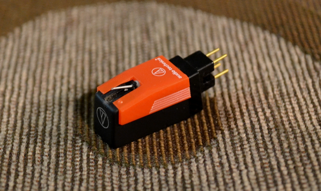

I didn't even bother to check what, if any, cartridge was on it until I got home. Low and behold:
An Audio Technica AT132EP with the original 0.2 x 0.7 mill nude elliptical stylus. I knew that model number rang a bell, but it took some quick googling to discover just how desirable this cartridge/stylus is. Certainly worth more than my $10 investment.
I don't have access to a microscope at home, but looking at the tip through an 8x Schneider Aspheric Loupe reveals that its really, really tiny. Much smaller than several other 0.2 x 0.7 ellipticals I have, until I compared it to my only other 0.2 x 0.7 mil nude elliptical, a Shure N91ED. Yep, it's tiny, too.
Of course, 8x magnification isn't sufficient to judge the condition of the diamond. That will have to wait. For now, I gave it a try and to my surprise, the turntable is 100% functional and it sounds great - so far. But, it was late and others were sleeping, so I had to keep the volume low. I'll give it some more critical listening tomorrow at normal volume levels and run it through its paces with my Shure Era IV test record. I've never owned a linear tracker (or any other P-mount turntable) before. So, I'm anxious to see how it does.
Assuming the stylus is in fine condition, what should I do with it? Just put it right back on the SL-5 and take it all into the office (my co-workers may be curious, but they are respectful, as is the cleaning crew). As mentioned the SL-5 is 100% functional (but missing 3 of its feet and has some scratches on the dust cover, which I can probably polish out). Is this too fine of a cartridge/stylus to relegate to casual background listening in an office environment. Is the SL-5 capable of showcasing the quality of this cartridge/stylus? Or, should I use a 1/2" to P-mount adapter to install it in a conventional headshell for use on one of my home tables, or is there a standard 1/2" cartridge that will accept this stylus? I feel like I have been blessed and want to take maximum advantage of my unexpected good fortune.
Assuming the stylus is in good shape, and knowing that it would be difficult to find another [affordable] ATN132EP, I'd keep it at home where presumably it will be safer and where it can be plugged into any of the series of cartridges represented by the AT120E without having to resort to any kind of adapter. I frequently use this type of stylus in my AT440MLa or AT140LC bodies.
This is a capable stylus and deserves to be heard in a good system in a quiet environment. In the SL-5, you could install an ATN112EP (still available NOS for reasonable $ if the worst should happen) in your AT132EP body.
Now, if your office is actually a safer/quieter environment than your home, or you don't already own a suitable standard-mount A-T body, or if the diamond is not in good shape...
