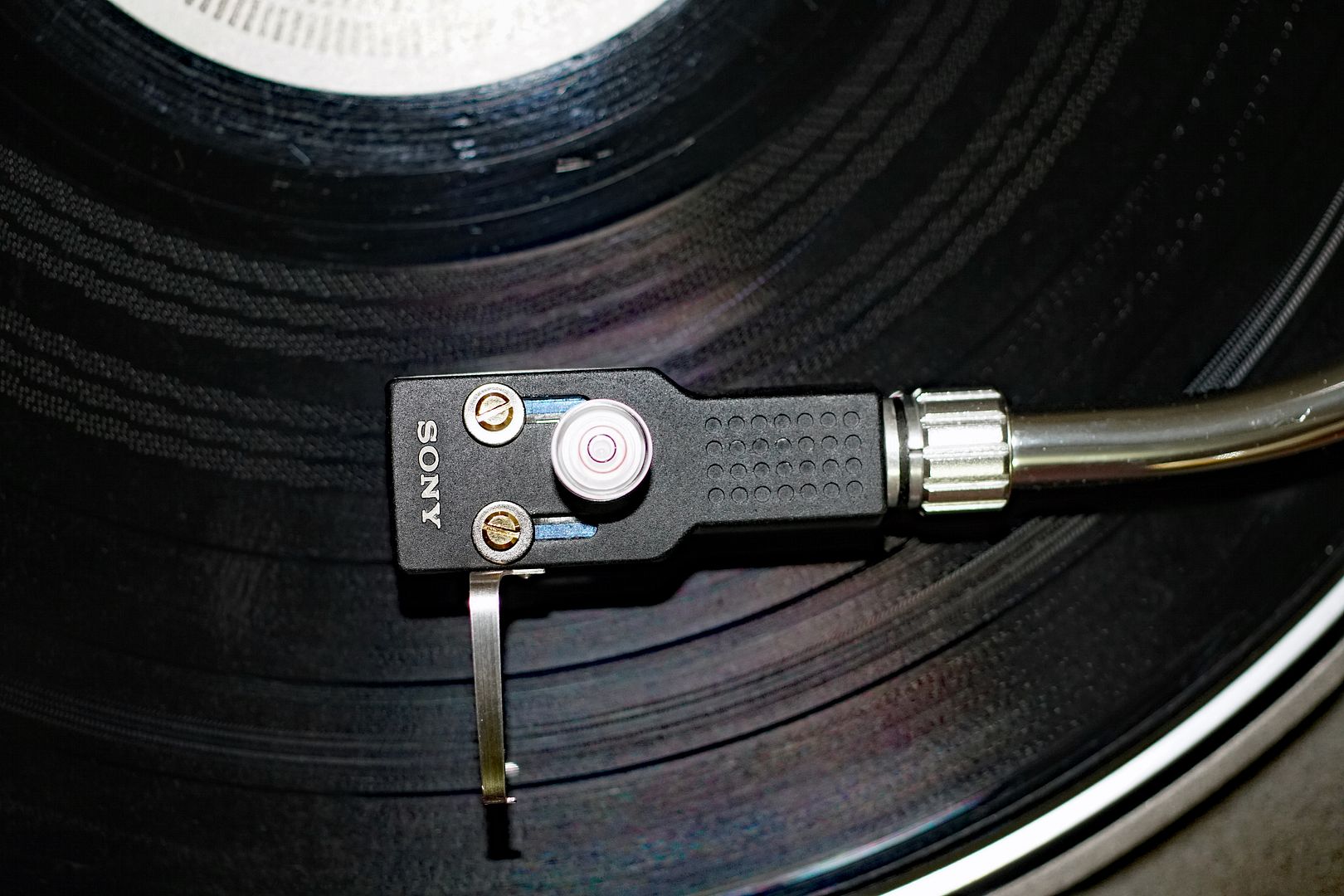

I use a small round bubble level on top of the headshell to check the vertical and horizontal (azimuth) alignment of the tonearm. This may help find if your arm is far off. I doubt that a new cartridge could correct an arm that is way out of alignment. :idea:
Place the bubble on the surface of the headshell, which is parallel to the LP's playing surface.

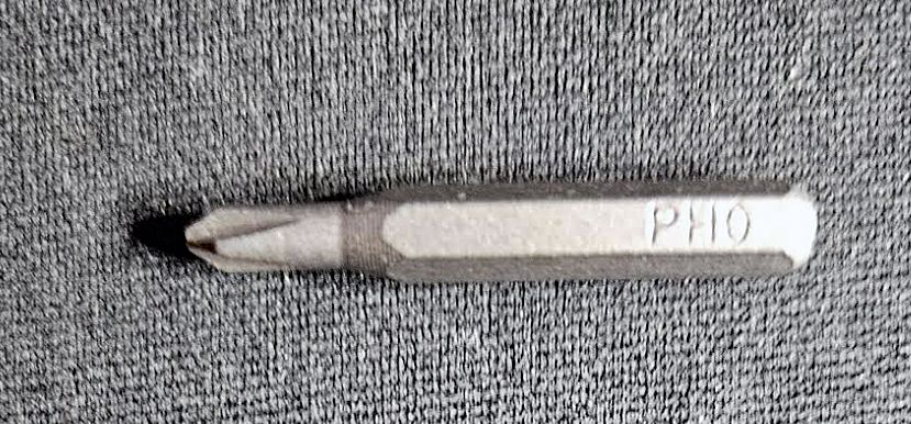

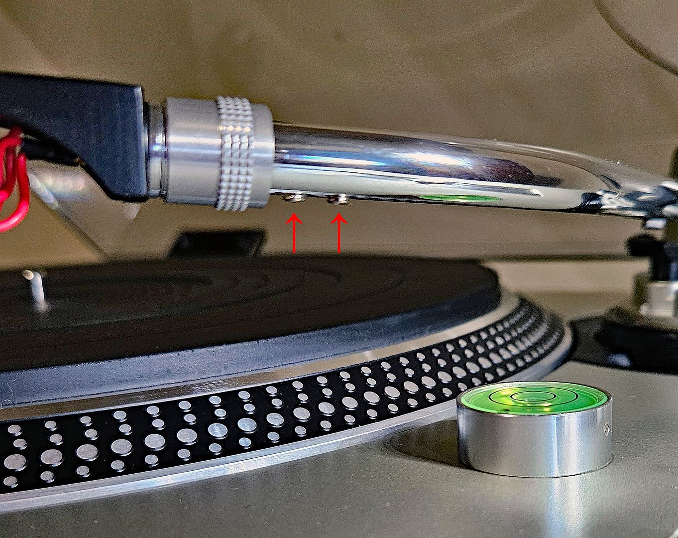

I have not checked the LP120X's tonearm, but on the Technics 1200, there are two set screws under the tonearm, just behind the knurled headshell connector. By SLIGHTLY loosening each, you can rotate the headshell. Do NOT remove the screws, as they are hard to align with the threads and reattach.
I use a PH0 Philips head adapter to access and loosen the screws.
