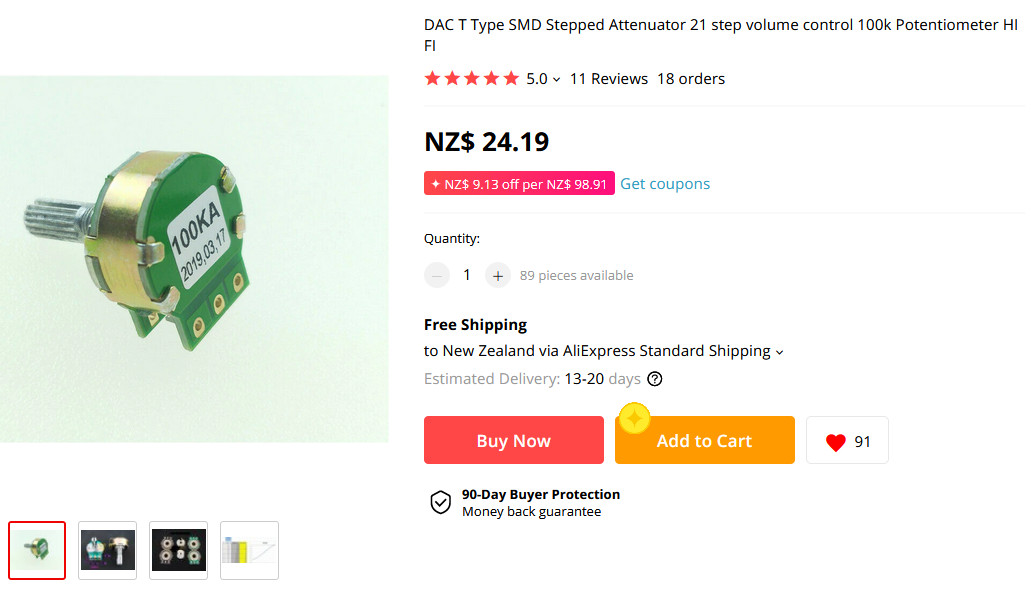

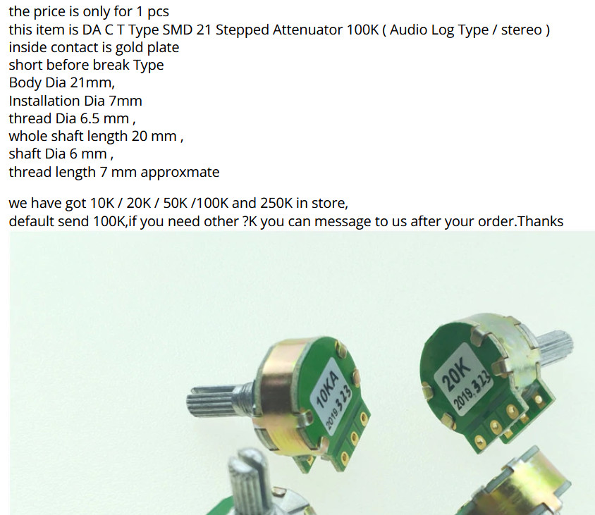

Is this what I need?
No. Put 10k between an amp and a speaker and how much current to you think it will pass to an 8 ohm load?
Basically what you're proposing isn't impossible but it wouldn't be wise. The way you're trying to control the volume is turning power into heat instead of the power driving the speakers. The volume control would have to dissipate far too much heat.
If you just want to level match the different speakers you might get away with using an L pad, but the best way to do it would be to have separate amps for each pair of speakers and control the volume by controlling the signal sent to each amp.
