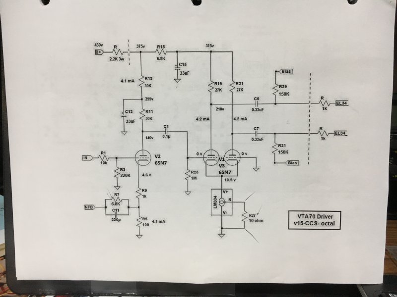

Can you verify that the CCS on the inverter stage is doing what it should? If that voltage is off, the phase inverter balance probably won't be right and that could cause some distortion. You should be seeing right near 200v on the plates of the inverter.

At R11 its 137v and at R12 its 137v same at P1 and P2. The voltage feeding into R11 and R12 is 261v. B+ is 386v.
Hm, B+ is low according to the schematic. Its calling for 430. Being 50v low to start with, the other voltages would also be off. That actually may be the root of the problem. Methinks it would be worth checking your main power supply voltages. If the rectifier is tired or if something else is causing the low voltage none of this is going to work as expected.
The inverter plates would be off R19 and R21, and whatever the equivalent is on the other channel. R11 is the plate resistor for the voltage amp stage. That one seems OK. Schematic calls for 140, 137 is plenty close enough.
