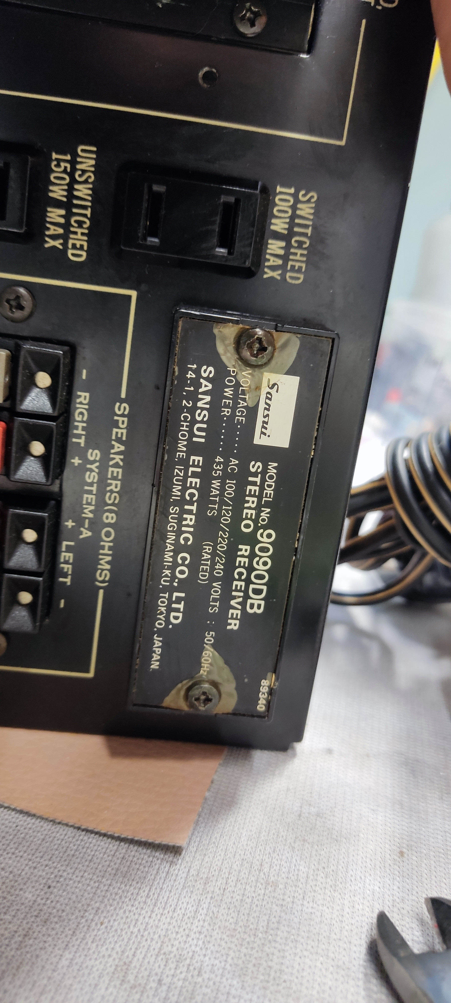

Sansui is famous for not documenting production changes so it is possible that your Dolby switch is different. Most Sansui "export" models have a voltage switch and can accept 4 different input voltages. I've never seen an exclusively 230V 9090DB. Can you post the serial number and a picture of the identification plate on the back panel? I'd like to document it in the database.

Hello Pete
Of course adds them. Here you are :)
The voltage switch (plug) is under the cover with the model # on it. Just take out the two screws to access it. It is a plug assembly that you plug in different configurations to set the voltage.
Thanks for posting the pictures. There is nothing unique about your 9090DB. It's a standard "export" model with the capability of 4 different input voltages. It was the 1966th unit off assembly line 81 in March of 1977. Sansui made 10s of thousands of 9090DBs. It may have had the power cord changed at some point but other than that it should be identical to the others made at that time. Based on the serial numbers in the database, Production line 81 was just building 9090DBs and the black trim version 990DBs that month. The highest production number on file for that month is 3945. Sansui was selling a lot of 9090DBs in 1977.
Sansui made 10s of thousands of these 9090DB export models. It may have had the power cord changed at some point but other than that it should be identical to the others made around that month. The chassis will be plain zinc plating and unless the driver board was replaced at some point it will have transistor bias control. Based on the serial numbers in the database, production line 81 was just building 9090DBs and the black trim version 990DBs that month. The highest production number on file for that month is 3945. Sansui was selling a lot of 9090DBs in 1977.
