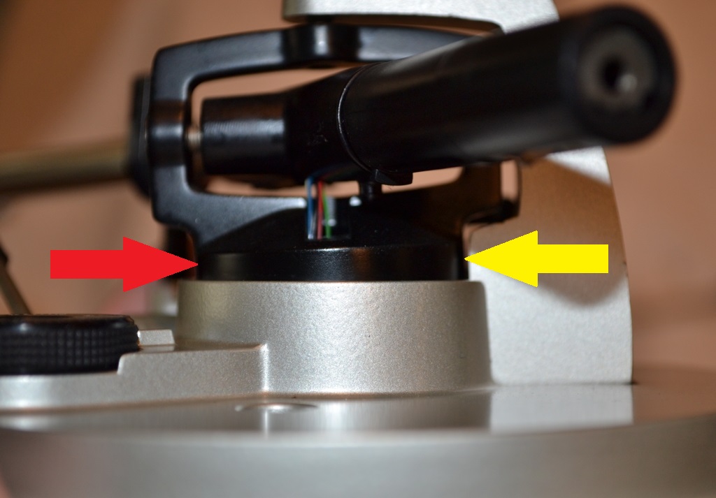

This afternoon, I finally got around to opening up the table to see if I could troubleshoot the issue. In ended up completely removing the arm so I could inspect all the levers, cams and springs on the underside, and check that the tonearm wires weren't catching on anything. The bearings seemed fine, as it floated freely in the vertical plane and for the first half of the horizontal plane. I was startihg to really scratch my head, when I noticed this:
For some reason the the bottom half of the gimbal mount seems to be sitting cockeyed in the base. Sure enough, as I manually rotated the arm, the outside surface of the black base would eventually start to rub on the inside surface of the silver well it sits in. What the heck, I've never seen anything like this.

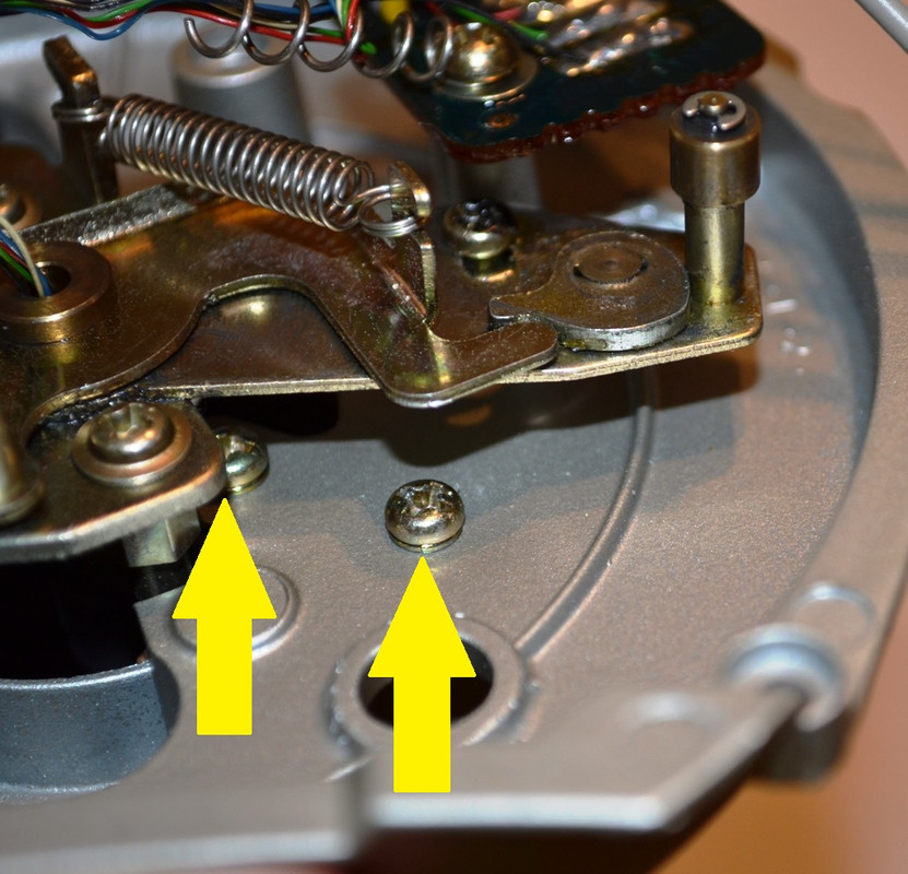

Then, I noticed this:

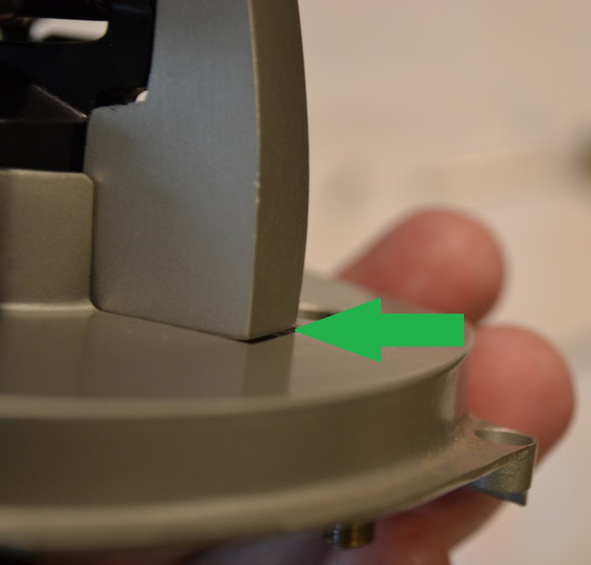

I turned it over and one of the screws (the one on the right) holding that upright support in place was a bit loose:
Tightening that screw completely relived the binding of the tonearm. I reassembled the table and am listening to my first album now. The first side played without any skipping, binding or other functional issues. It played through from start to finish, the auto-return worked and everything seems fine - 100% functional. The second side is nearing completion now, again with no functional issues.
So, here's my question: visually the gimbal still looks cockeyed in the base and there is still a small gap between the right side of the vertical support and the base it's attached to. Will this cockeyed gimbal cause potential performance issues - specifically in regards to azimuth alignment? If everything is working functionally, with no binding or other issues (tonearm floating freely in both planes), should I be concerned or am I making an mountain out of a molehill?
