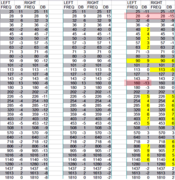

The digital filters REW creates are quite complex with no real limits on exactly what frequencies are treated. Not so with an analog parametric ... my SH9010 is limited to five filters per channel. There, you need to do a bit of head scratching to target the worst offenders. Here's a sample printout from REW with those highlighted, including the center frequencies and bandwidths I wanted the PEQ to address.
... and here's a cheat sheet I built to set the controls on the PEQ ...
That also incorporates a "room curve" to get away from the tasteless flat sound mentioned earlier. You'll notice no correspondence channel to channel as the room shows major inconsistencies side to side. Also, the top filters are reserved for "shelf filters" ... those allow me to adjust the top end on the fly based on whatever the media presents. Sort of a glorified treble or brightness control, only better.

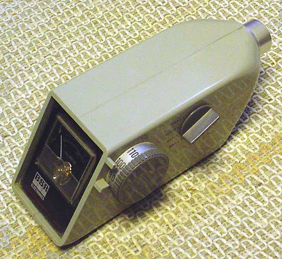

Still got my trusty lil BSR meter on the side table. At least I know why my ears are bleeding.
