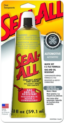

I have always used "Seal-All" for this. Dries clear and never gets brittle. You can get it at any hardware store of auto parts store.

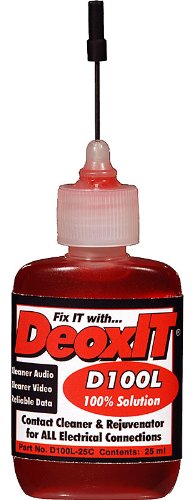

Great! Thanks for your help I will print your suggestions and take them with me, as this seems to be a gremlin kind of day as I waited too long on the can of deOxit and just about ran out, so I am looking for glue and deOxit, the latter is hard to find in local stores so I may just settle for the radio shack brand.

I lucked out and got a spray can at a different radio shack, the one I stopped at this morning was out. Trans I do like the needle applicator and will try it out as the spray applicator even on lowest setting and nozzle does make a mess even though I always try to mask with a paper towel, but still you need to clean up and let it dry, which is what I am doing now. I will go with the 5 min epoxy glue as I already have some and will glue up the knobs, and then test run how it sounds before I put everything back together. My wife, much better ears, could hear some slight noise when balance control was moved so hopefully the cleaning will have removed this.
