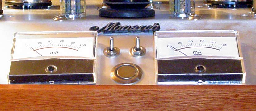

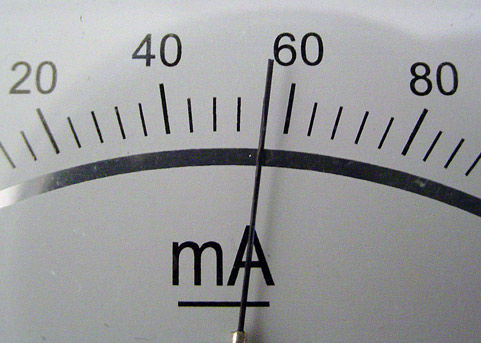

Perhaps the bias on your pic is too high as we're not seeing anything. Something is amiss at "brainfartz.com". ;)
New pic - maybe it hasn't caught up with your end of the world yet ...
Well, your meters are indicating the quiescent current that results from the bias setting.
My bad - Was actually being my usual facetious self here. The mA meters are measuring mV - I've fine tuned the circuit to where it's easy to match points for the recommended 55mV per tube and the 60mV I usually run the KT120's at.
(And ya, I know, the scale is off, but it makes for an easy visual. I use a VOM to match the meters to the bias test points using a VR. Long as I know what's happening, I'm good with it.)
I double check occasionally with the VOM, and on the fly settings using just the meters are surprisingly close. I also take them completely out of circuit during normal operation using a center off switch.
Why use mA meters? Because I like the old school look on these, and it was an easy mod - just a simple snip on an internal shunt resistor is all. ;-}
I like your meters but I am confused. If the meters are already made as current meters with at proper shunt why snip it out? What replaces the shunt?

And of course, in an effort to complicate things again, here's a pic of my bias meters on the latest build ... MA you say? ;-}
I see your switches now and switching them out for their safety is a good idea. . They also provide a way to see when you leave class A. Nice touch.
Also nice they say mA on them since that is what you are reading, the shunt is just elsewhere now. If it turned out that your original measuring resistor was the same as the shunt you were very lucky. Most current meters are set for full scale at 50 mV as that is a common shunt.
