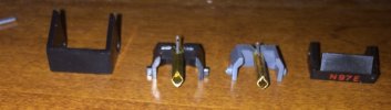

Hi everyone,
I recently bought one copy of, I thought would be a N95HE made by Zafira. So the box said. But inside of the box I found a stylus which is certainly not a N95 of any kind. I tried to put it in M44/55, M75, N91, it is sticking out of all of them. So yeah, you got it right, I have no idea what it is. Can some of you help me out? Thanks in advance!

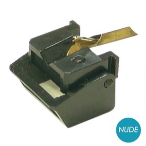

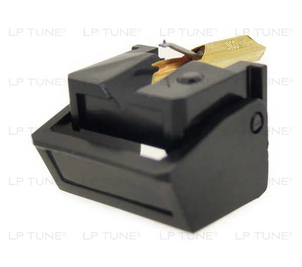

There are no after-market styli that will match the original Shure N95HE "nude" hyper-elliptical
The closest in sound and build quality are from JICO in Japan
That’s definitely a cheap aftermarket version of an N95 stylus. The aftermarkets share traits. And definitely not a stylus for a flat-bottomed M44/55/91/75/V15-I or V15-II.
Yours:
Kyowa (left) and Swiss made (right):
Yes, absolutely looks like a stylus for the M95.
EDIT - :oops: I am mistaken about this, see posts from @malden. Next time I will use my glasses while using AK ;)
