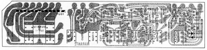

I followed the full voltage readings back to PU01. I documented the resistor and transistor voltage readings. A few resistors need to be replaced because of the peeling of the external casings, but I did not see any resistors that looked damaged or burned. I previously replaced the CAPS and transistors on this board for this restoration.
Looking at your schematic, your voltage measurement of JU08 doesn't look right.
JU08 is tied to chassis ground but measures 30VDC?? Where did you have the DMM black lead.. on the chassis?
JU08 should be 0VDC with respect to the chassis, not 30VDC. Is there a wire on JU08 that is tied to the chassis, typically a black wire. Maybe you forgot to reconnect a lug to a ground screw on the chassis when you removed the board? You can test this with POWER OFF and UNPLUGGED, put your DMM into ohms and measure the resistance from JU08 to chassis ground. What do you get?
JU04, you measured at 0v which is correct so the chassis ground is not the problem. It has something to do with JU08?
You also have a huge DC voltage on JU06 & JU07. That shouldn't be there also.
Carefully examine the solder pads on the PU01 board for solder shorts. If you post a good photo of the top and bottom sides of the board so I can also look at it. Compare it to the layout below. Follow the ground trace JU08 through its path and make sure there are no solder blobs connecting to another trace.
SOLVED!
I was able to locate a broken ground wire that led back to JU08. I ran From JU08 to the crossfader and between the crossfader and ground near the P400 Phono stage. I replaced the broken ground wire and high voltage readings at 0VDC at JU08, JU06, and 3.5mv at JU07.
