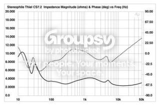

4 ohm posts :thmbsp:
8 ohm posts and you'll go eventually go into thermal shutdown as look at all the frequency ranges where the impedance is less than 8 ohms...
Talk about some wild impedance (and phase) swings!!! that is why the 802s are hard on amps
Now look at a Thiel CS7.2... much less impedance and phase variance thru the midrange :thmbsp:
I might try running them on the 8 ohm posts and mount some fans over the rear of the amps! j/k
Check out the Peak Consult Empress. Is this a well behaved speaker or what? :thmbsp:
:thmbsp: It doesn't get much flatter than that!
Check out my previous post as I replaced the CS6 with the CS7.2...even flatter than CS6!!!
