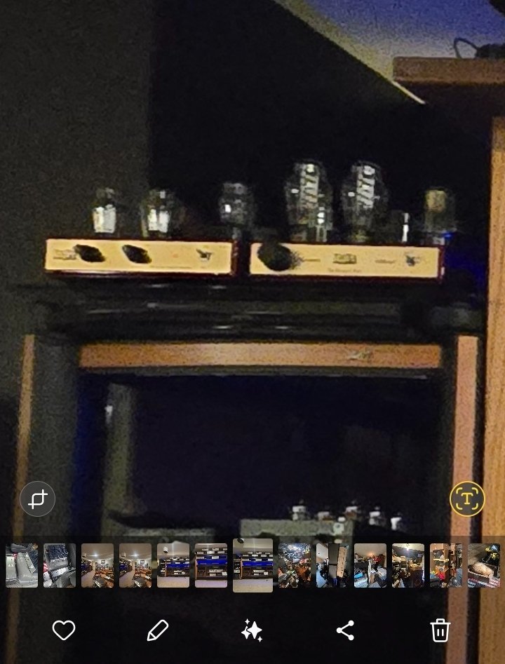

Since i have my R300 on the bench installing new pots, i took the time to measure a few more things. I have noticed if i use 5AR4 rec tubes and the EH 300b and set bias needle in the middle of the scale, this gives 75% dissipation. I have 461B+ and 426 plate with the bias at .70ma. These 5AR4 tubes bump the B+ and the plate voltage up quite a bit . If using a 5U4G and set bias needle in middle, im set to 70% dissipation. At this setting i have 437B+ and 406 plate voltage. Now, if setting to a lower bias and using 5U4G with Sophia Electric Princess 300B/n tubes, i set the bias at .60ma, this gives a dissipation of 65% with 448 B+ and 420v on the plate. The needle is set between the 2 smaller marks left of center for this setting. So, if your using a mesh plate tube, you might want to be careful what rec tubes your plugging in. Yes, the 5AR4 slows the current surge at start up, but looks to me carries constant higher voltage once current surge has completed. I could be wrong, but i dont think that would be a good thing for longevity on the mesh type 300B/n. According to StepheK studies on this amp, comparing notes to what she had on one video, the 274B would have similar voltages as the 5U4G.
One other thing i measured is the resistor in the bias path, one measures 10.5 and the other 10.3. This explains why my bias reads .1ma different between the two when the needle is straight up set in the middle.
