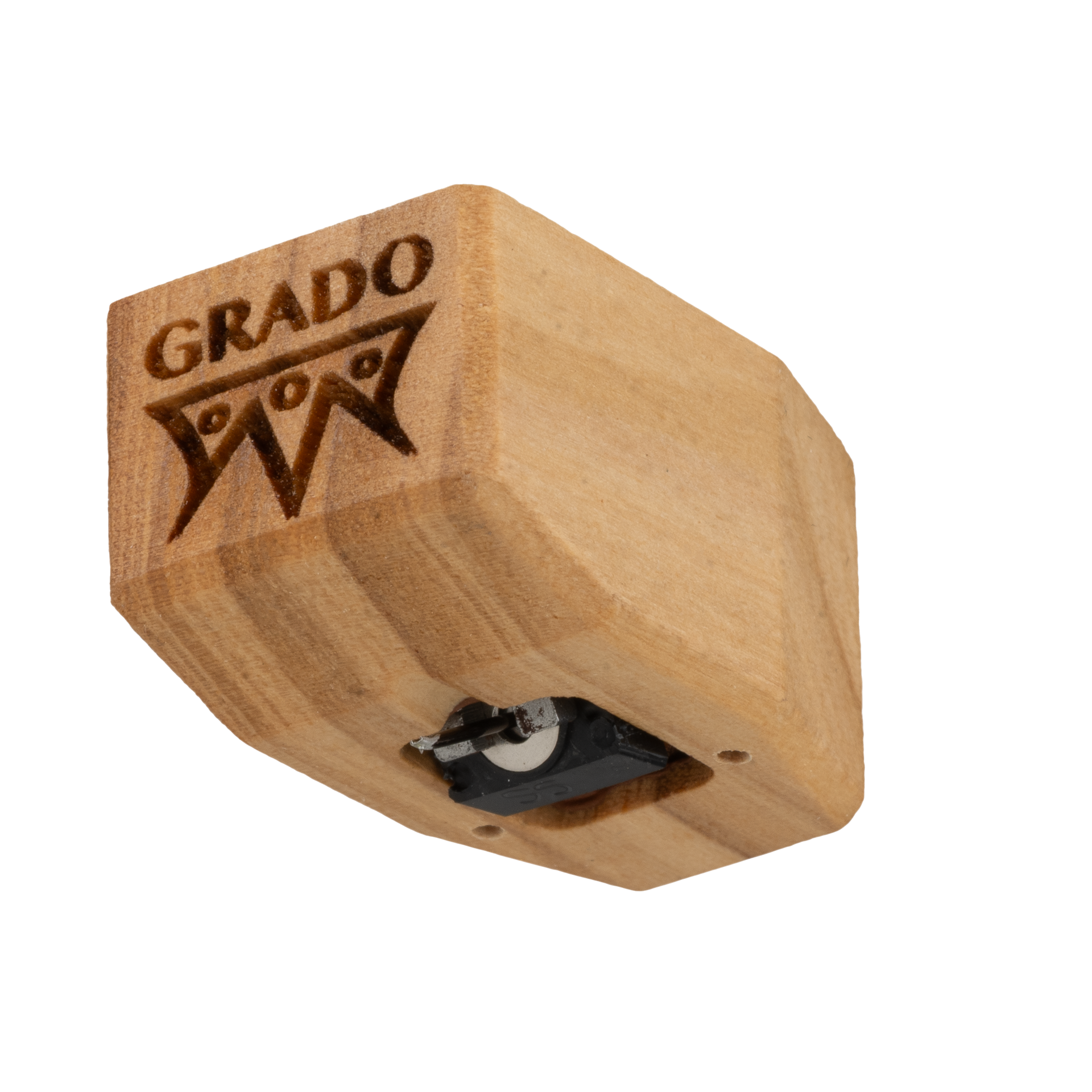

Wood body Grado cartridges ?
Has anyone compared the grado woodies vs the blue or the gold? Is there much difference in the sound if they are using the same engine? The price on the blue is very appealing..
I have a blue and a gold, both fitted with an 8MZ stylus, also a Platinum wood body and it blew them away until the maidinator took out it's cantilever.
One of these days it might get re-tipped, I'm using LOMC more now.

The Platinum 3 is essentially identical to the Opus 3 with a different type of wood body. The damping is excellent with both. My advice is get the cheaper Opus and put the money you save towards a retip.

Yet Opus3 and Platinum3 sound different, Platinum is richer/ slightly darker in sound. Coils are not the only parameter that decides on a final sound. Platinum3 is overall a better cartridge, especially on a better rest of the system.
I have heard both and I don't agree. On a well damped arm they sound identical. The only reason I can think for the Platinum to sound darker is either it is faulty, or you are comparing high and low outputs, using different loadings maybe..? The Platinum with be slightly better damped but both carts have good damping. The only thing that may account for a different sound is the heavier body of the Platinum. Grado like a light ish arm is light medium compliance and with the heavier Platinum this is even harder to achieve for many of today's arms. When I tried the Platinum I used a VERY light headshell and happily the counterweight was close to the pivot point which helps effective mass be as low as possible. Maybe a compliance issue?
If we are talking Platinum 2 then I agree it is darker, but not 3, at least not the ones I have heard.

I have no deisire to argue and I will not return your rudness. I have opened up various wood bodies and the engine stays the same on the ones I opened. If you want to believe otnerwise that is fine, it is your choice. The cheaper red blue siver gold are the same. Grado says the best of the red become a blue and the best of the blue become a gold. If this was true you would always fine better channel balance and separation on the higher models and better stylus alignment too. Reality is I have measured far better channel balance and separation on a blue than a gold with better stylus alignment too. The gold and silver have better stylus dampig but I am not sure I like the change it makes. Grado are lovely carts, few carts at any price compare re separation and the independant Grado family should be celibrated for this achievement. That said they are famous for smoke and mirrors in the specs and not very forthcoming when asked what the real differences between models are. If you buy any other cart, maybe a Koetsu or Dynavector for example in the description and specs the differences are highlighted. With Grado there is only inference as to differences, reading the description for the Platinum for example it reads as if it is a step up for the Opus and it has dual magnets but the opus does not. But the Opus too does have dual magnets also, they are not lying but it is clever wording.
What do you think they can possibly change between the Opus and the Platinum? The coils are identical as is the stylus assembly (I have had them both apart). The glue is the same and the wood is different, the only difference.. I am no genuis, but I do know carts and unlike you I have totally stripped down both out of interest so I know what the differences or lack of are. As you have not I can not really see how you can claim the carts are so different in construction.
If someone has a light lively arm maybe the wood in the Platinum is worthwhile, otherwise I cant recommend the Platinum. Other models with better cantilever and stylus are of course different in that respect.

Any difference is sound is not from the engine they are exactly the same. Maybe the wood (I already siad this) on your arm is making a suptle change or maybe it is slight engine to engine variations making the difference (mayne one has more damping glue..

My feeling is the low output Opus is worth the extra (blue only high output) Also the glue and the wood adds postive sound due to damping, but the blue , actually the black too sound very good indeed especially for the price paid.
