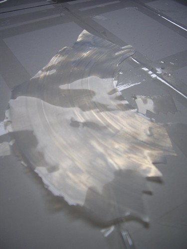

To answer my own post. I bought a bottle of this (£5.60 for a 1 litre bottle) and tried
it out yesterday.
I let it dry overnight and tried to peel it off but it tended to break into sharp pieces.
I suspect I didn't use enough? The other side has now been done and is drying out
as I type this.
Results were very encouraging. It's not an LP in great condition but the glue certainly
cleaned up the sound. The LP previously had a fair bit of background noise that
I believe was ground-in dirt. Now? Gone. :D Clean & crisp detail flowed from the
record.
I'll be doing this many more times. :smoke:

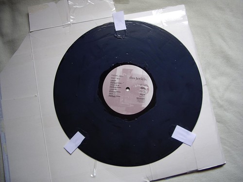

More tales using Screwfix's 'No Nonsense Wood Glue' (£5.60 for a 1lt bottle or £20 for a big 5lt jerry can...)
I went to town on a rather tatty copy of The Blue Niles 'Walk across the Rooftops'
that I bought second hand a few years ago for £1.
All I can say is wow. This LP now sounds like it's just left the pressing plant. All dirt is
completely gone. Trick is to make sure you use enough at the lead-in and lead-out
grooves - makes it easier to peel off. Like icing a cake...

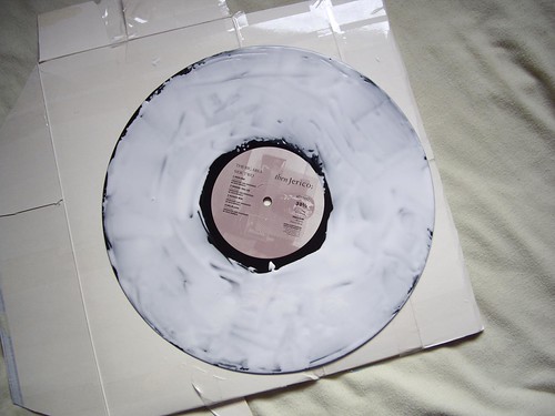

Side 1...

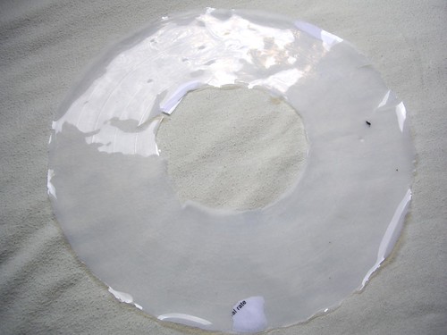

Side 2 after cleaning...
That Blue Nile LP now sounds amazing. I was ready for chucking it and getting a
new copy of it. Glad I didn't. It cost me 5 minutes of my time to give it good coating
of glue, then let it dry for 20 hours. No skin off my nose how long it takes to dry
out - I can do more LPs in that time.
