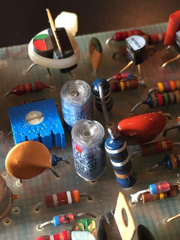

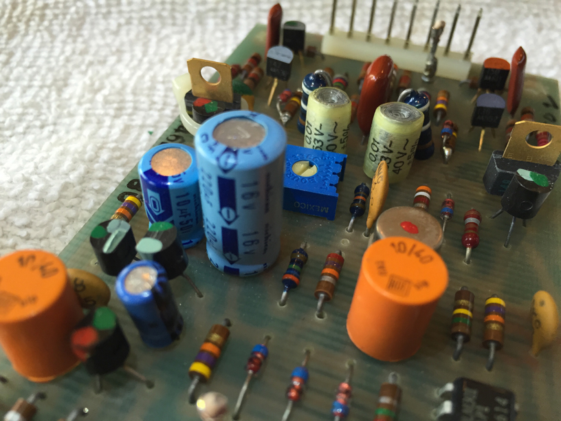

Here are some things I found today while recapping the left channel PCB.
1- I was a little surprised to find that the electolytics on the channel cards were Nichicon. (See photo.) Are these original parts? There were also two ROE bipolar caps as well, which I expected. [BTW: I decided to replace the electrolytics with Elna Silmic II and the bipolars with WIMA.]
2- The .01uF poly caps (ERO KP1834) on each card look different: one set is yellowish-white but the other set is silvery grey. (See photos below.) Is this normal or does it indicate a problem? Also, the tolerance on the ERO parts is 5% while the service manual indicates that 064-142 should be a 2% part.

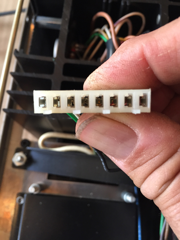

3- If the connectors for the cards are Molex, it's not a type I've ever seen before. The pins are rectangular, not round. (See photo.)

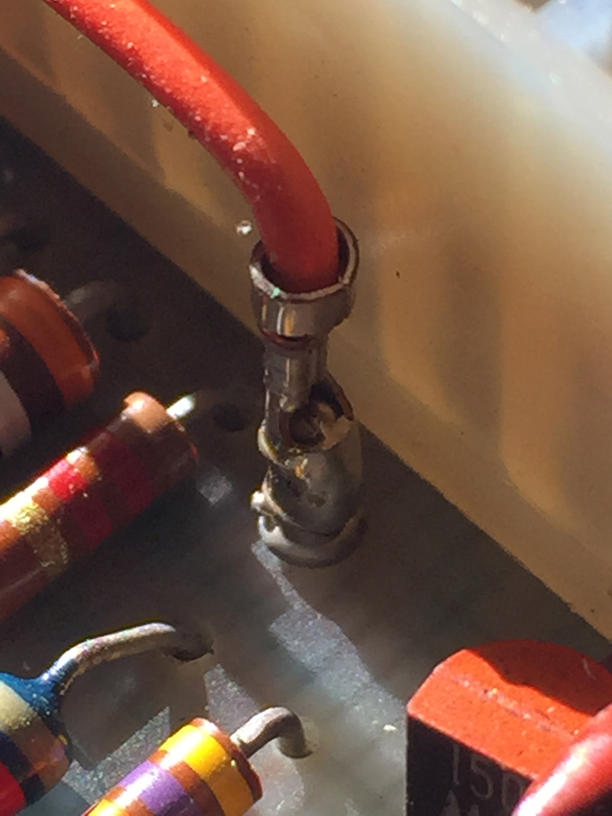

4- Two connections are made to each PCB using a short pin soldered to the board and a crimp-on Molex-like terminal. These carry Headphone Out and Input Limiter. Dunno if the terminals are normally soldered to the pins but they were on my PCBs. It was a complete PITA separating them and I had to replace the terminals which were destroyed in the process. [EDIT: now that I've worked on the second card, I don't actually think these connectors were soldered together---they were just very very tightly mated.]
Someone has been there before, most likely chasing an intermittant.

@c_dk: So the Nichicons are not original then! I see them on the inputs too----which is odd because A) very difficult to get to and B) they are electrolyics when the SM specifies bipolar. Benign or should I replace?
What about the connectors: originals or replacements?
I see them on the inputs too----which is odd because A) very difficult to get to and B) they are electrolytic when the SM specifies bipolar. Benign or should I replace?
I saw blue Panasonic's on the Mac I did and they appeared to be stock to me, they were date code correct for the manufacture of the amp which was like 1979...

I see your 5% film caps and they don't match original in my 2205 I worked on. This circuitry is feedback related, and has only high precision devices located near by it. I would tend to try and find the 2% original style parts from any manufacture and duplicate for both channels as best as possible. I have only seen 2% parts where your questioning, and the resistors near by connected are similar tolerances so I think Mac knew what they were doing and I would try my best to mimic Mac's original design just in this specific area... but this is my opinion and YMMV and others my disagree..........
The itty bitty blue caps behind the RCAs are bi-polar and WIMA 2.2ufd fits nicely there but you will likley have to de-solder the RCA connections to the board to access the board clearly on both side to replace the electrolytic, and then resolder the RCAs back to the mini board, after you clean and de-oxit it the RCAs themselves including the inner tip sleeve.. Be aware of the hard wiring trying to break off while you handling the board like this. You may end up reattaching a wire or two due to embrittlement of the aging cabling....Just reattach as needed with fresh solder and you should be golden...

Oh replace those orange ERO bi-polars either with WIMA's < PM me for link to correct size parts links > ~ $5. something each , not cheap but the best never is > Or Elna Silmac II's or Nichicon Muse, your choice, but the film caps I suggest will out last your lifetime most likely...and you can 0.1 ufd bypass them if you like here again they serve one sole purpose and that is to block DC offsets or they are AC coupling caps...all in the semantics I guess lol....
And there is 0.47 ufd wet cap up front before the input. Again you can WIMA, or Elna SIlmac II or Nichicon, your choice. And you can 0.1 bypass if you like also I believe.
There have been some posting here on the AK where at least one other person upped this part spec to a 1.0ufd device. They proclaimed it enhanced bass bottom end. Which is possible since at 0.47 ufd I think Mac may have meant to provide some sort of sub sonic roll off with this value along with providing AC coupling and DC blocking. Its a fairly odd value from just about every other amp I ever saw in my lifetime so the sub sonic roll off is just a guess without spice modeling the circuit and due to the age of the parts involve no Spice models exist for these transistor... so out on a limb I best guess its a roll off thing along with AC coupling, because you got 1.0 to 2.2 on the RCa's already,a nd two 10ufd bi-polars after this input circuitry so 0.47 ufd is no where near the rest of the circuits design ideas... best guessing though...YMMV and so will opinions...
Your connectors look stock, c-dk is right someone has been chasing intermittent connections by soldering on some of the connections it would appear at first glance.
OK hope this doesn't tee anyone off but here it goes.. Way back when this amp was built these connectors were state of the art. Now not so much. Times and tech change as does experience which is usually the thing that changes everything.
I kind of hate these connector plugs but unless you want to do drastic things your kind of stuck with them. I hate IC sockets also for similar reasons. but these conveniences make assembly and repair work on a monster like this a lot easier to perform.
So unless you want to hard wire these driver boards < which I am not even trying to convince you to do > Your kind SOL and need to perhaps if your in doubt rebuild these connectors for the next 39 years of use.
As I said your options are very limited IMHO, and if your into originality then rebuild these plugs as you see fit. I suggest you look long and hard for heavy gold plated contact inserts, they don't corrode. And gold contacts will cost you dearly now that gold is where it is price wise.

All the electrolytics on both channel cards were replaced with Elna Silmic II and the bipolars w/ WIMA. It was pretty straightforward. I'll send a photo tomorrow. I also replaced most of the caps on the meter board because I had some extra parts. To finish that part of the job up I need a couple more electrolytics (22uF and 47uF---the latter is also a ROE ;->) The WATTS setting now seems to work correctly for the first time since purchasing the amp so obviously something was wonky.
I guess I'll also need to find a replacement for those ERO polyester film caps if in fact they are not the original parts. And kind of weird about the difference in color on the two boards. I did some googling but didn't see any mention of color differences either because of production or aging.
