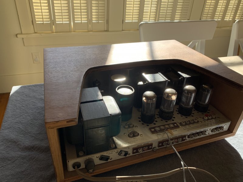

Greetings All and Hello! I've been reading through this forum like crazy and hope I can get some guidance from all the knowledge here. My apologies if this turns into a bit of a long post.
My father purchased this amp new and at some point upgraded to new equipment, put the x-101-c on a shelf in the basement, and there it sat for at least 30+ years (I'm 32 and never seen it in action). He states it was working when he put on the shelf and to the best I can tell everything is original except for one of the 7591 tubes is a different brand. Fast forward to a couple of weeks ago, family was over which resulted in the amp getting pulled out, admired, and eventually hooked up and plugged in (not the right way to go about it I know :(). Before I get to the issues, here are some pics:
When plugged in all of the tubes glowed like normal, however, there were the following issues:
  1. There was no sound output.

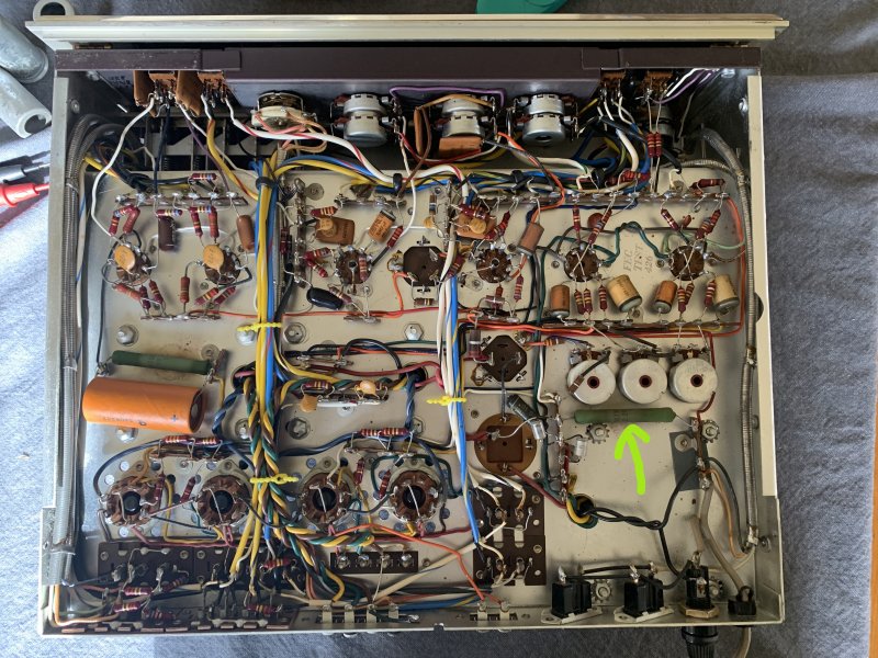

  2. The resistor indicated in the following picture became very hot (220+ degrees F) within about 10 seconds and began to smoke. Once this occurred the amp was unplugged.

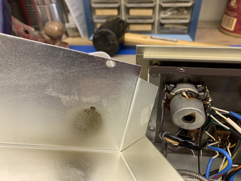

  3. As I've learned is a common problem, the volume pot/switch does not click to off. The amp remains on unless unplugged. Additionally, the case and rear of the volume pot appear to have experienced some heat as seen here:
Since it's brief moment being plugged in, the only thing I have done is test the "hot" resistor which showed as normal on the multimeter.
This is where I turn to all of your amazing knowledge. Where do I start with all of this to make sure I don't cause any more issues?
(For background I am mechanically inclined although knowledge of the inner workings of electronics is at the bottom of my knowledge bank. I have experience building RC cars and the like so I'm comfortable soldering etc. but aside from that this is pretty far out of my element. With that being said the more you can "explain it like I'm five" the better and greatly appreciate the extra time that takes).

Just so you know, that green resistor that you said got hot gets hot under normal operating conditions. Whether it is excessively hot depends on the condition of the capacitor it is servicing. For me, that is always the first port of call: the multi section can capacitors. I address them ALWAYS. Some folk just replace the section that is leaky or shorted but I just rather replace the entire assembly. But that's just me. Once you get everything clean and the amp is run through a variac, you can begin your analysis and formulate a restoration plan that will make your instrument run safely and with confidence.

It's very possible that someone sprayed contact cleaner into the power switch at one time causing it to cause a brief fire or blowout. I had one of my Fisher units that had similar damage, if not worse. I was able to find a replacement, although common for these switches to fail, not common for them to show such a burn out. Most should know anything liquid and possibly flammable should not be sprayed into these switches, only the control pots. Your amp should really be nice when finished! :thumbsup:

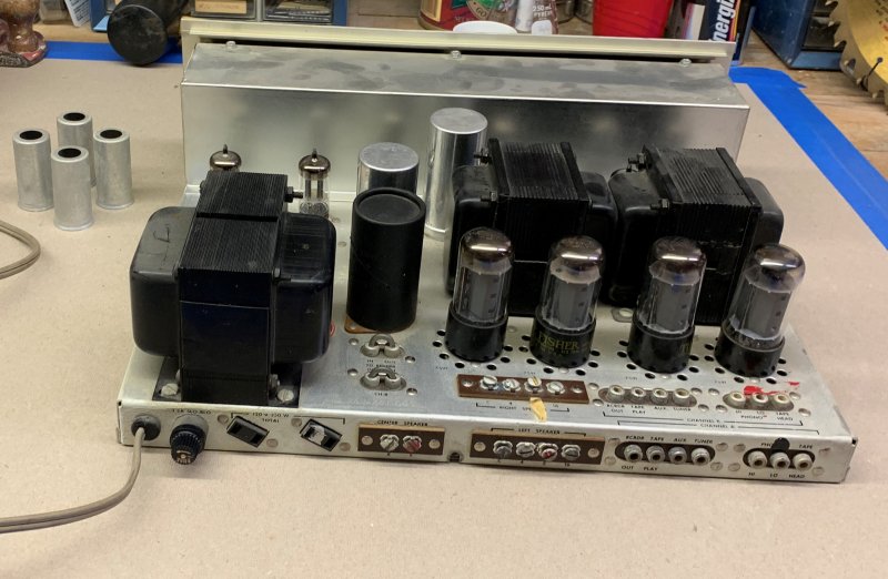

It's alive! So I went through and carefully cleaned all of the switches, contacts, etc. and then powered it up slowly over a couple of days on the variac before reaching full power and giving it a test. The hot/smoking resistor problem is gone and I have sound output! I didn't have time to give it an in-depth listen or test anything other than the main speaker output but so far I haven't heard any obvious buzzing, popping, or other unfriendly noises.
I think my next steps are going to be:
1. Check/adjust the bias.
2. Replace electrolytic capacitors.
3. Replace the faulty power switch.
4. Test and replace any other out of spec capacitors and resistors.
For the bias is it as simple as taking a voltage reading at pin 5 of an output tube and using the bias trim pot to adjust to about 40v? Multimeter red lead to pin 5 connection and black lead to a ground point?
