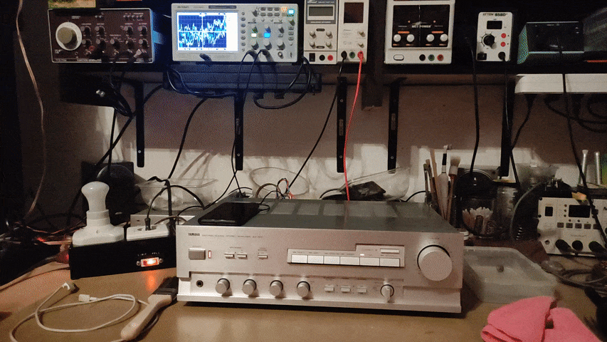

So even though I do not have a dummy load yet I found the time (and balls) to do some testing and I can report that the amp is working again ... well at least partially. I had an old Audio-Technica ATH-M50X head phone laying around that shows its age age somewhat (the pleather is peeling off) and that I wasn't too worried about blowing up though I thought the chance of that happening on the head phone out were not so likely.
So I first started with a 60W bulb in the dim bulb tester and after turning it on the click from the relay could be heard. Great! So it looks like getting rid of the dry / old joints and removing the corroded resistor leg and links fixed the issue. The main culprit probably was the rotted through leg of that one resistor, afaik that's directly related to the protection circuitry. I then proceeded to hook up an old phone and looked up a 1KHz sine wave video to use as a tone generator. I felt this was easier for the moment than interfacing my crappy Toellner waveform generator (can be seen in the top left corner of my shelf next to the scope) to the RCA input of the amp. I admit was lazy and I had setup the MBO sound system that I inherited from my grandparents just a couple of minutes before so everthing was easy to connect. Anyway at first I was confused that the volume was so low, but that was probably due to the current limit of the dim bulb tester. CD direct however made the signal much louder on my headphones I don't know why. I also hooked up my digi scope to the speaker outputs and was again confused by the oscillating second channel but turns out it was just me being to stupid to set up the scope correctly and poor connection on the probes.

There is still a bit of hum so I get the cover back on but I do not know if that helped that much. Anyway it seems like the preamp board is prone to vibration and I suspect that this is either more cold joints or more likely dirty switches. Down below is a picture of a distorted sine wave from the speaker output that I could also hear in on the headphones. So it's in the preamp already and the amp is just outputting that signal to the speakers.
Does anyone know how to clean the input selector switches? Sure, yeah, washing with deoxit or similar I guess. I got Kontakt 61 (Contact cleaner) and Kontak WL (Washing Liquid). The switches look quite well encapsulated and I don't really want to open them if I don't have to. Any hints?

I don't know what they look like. I've tried carburator cleaner, isoprophyl alcohol, deoxit, nail polish remover...for stubborn pots; and have had to eventually disassemble them, finding a gelatinous goo, or an oily-black carbon requiring scrubbing with a brass brush. Even drilling a small hole for solvent spraying, has not helped. Have a pic? Lol.
Well I did a pass of Kontak 61 but didn't turn off the amp so that probably wasn't so smart, idk. Anyway at first I had some issues and the latching of the switches got worse but then I left the more aggressive Kontak 60 to work over night and it was mostly fine afterwards. All the cans are expired, lol. I found some super old Kontakt WL and the cans didn't have any pressure left. Anyway I washed the switches with that and now waiting for it to evaporate. I think it will be fine. Most of the noise is gone now. Haven't washed the potentiometers yet but they are mostly quiet now so I don't see the need for doing this. I also used compressed air to work in the Kontakt WL some more and a syringe with a needle to directly apply it into the switches from the front. Meh ... time will tell if this issue resurfaces but as far as I know it will resurface. Just a matter of time. I really dread the day when I have to take these switches apart but in any case I am not sure how much usage that amp is going to see anyway.

So I tested the amp on some speakers and it seems to work well now. I went on to check the idle current and it seemed a bit high at roughly 27mV and 21mV on both channels respectively. Don't mind the two multimeters in parallel, this was intentional to check which one had the better resolution (it's the Fluke - I've forgotten this over the years).
The service manual states 10mV +/-2mV for the idle current measurement. So anything between 8mV and 12mV should be fine. I've adjusted the values to 10.55mV an 10.44mV which was the best I could do with the sensitive single turn ports. I considered replacing them for 10 gang trim pots but I left it stock for the moment.
I am not sure if I did anything wrong but the values seem to drift around a little. After some listening to music I ended up with 12.60mV and 10.34mV. Not sure what's going on here. I wonder >when< the measurement should be carried out. I would assume after the amp has reached thermal equilibrium but that would just be my guess. The service manual just states "measure under no input or load condition" and that is what I did and after some warmup / stabilization of the values. I disconnected the speakers (via the switches) and removed the input RCA plugs. Tone generator still hooked up to the inputs in the picture but the values are for the moment at what's shown in the picture. They will probably change again after listening to some music even if brought back to the no load / no input condition again. Hmm idk. It's probably fine.

Idle current seems to stabilize at 10.60mV / 10.80mV or there about when warmed up. So I went on to clean the pots on the front. After all the bass tone pot was noisy. DC at the speakers seems to be R 40mV / L 80mV. Not too great but also not an issue according to some forums posts that I've looked at. There is no way to adjust this inside the amp anyway.
So I am considering this fixed and I got off easy. No defective components really besides the rotted through resistor and some links. Haven't testes phono though since I don't really have a phono record player.
