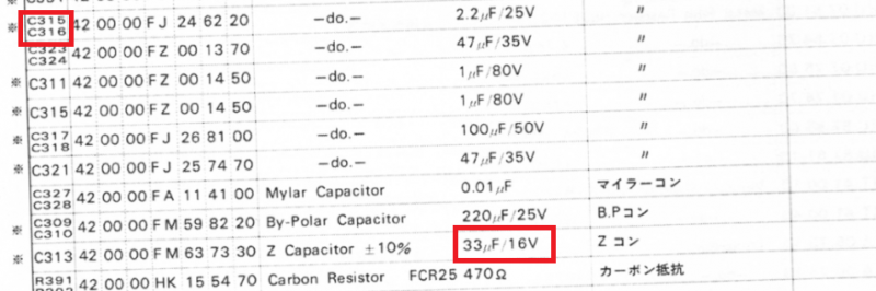

Just one more question because when I checked in the part list and 33µf/16v was pointed as number C313 and C316 is 2.2µf/25v

Just to be sure that I changed the correct one, below is a picture and in red circle is the capacitor I have changed.
