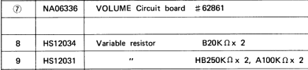

Refer to the taper shown in parts list, A=Audio=log, B=linear taper.

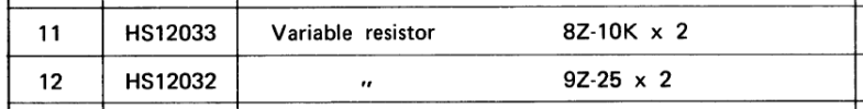

I didn't understand the parts list designation of "A" & "B"
What does HB stand for?
What does 8Z and 9Z stand for?
A or B or ? Curve?
HS12034
CURVE OF POT ACTUAL MEASUREMENTS
RESISTANCE IS VERTICAL, DETENTS ARE HORIZONTAL
10K HS12033
