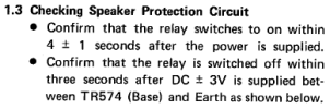

The service manual shows how to test the protection circuit
The corollary of the above is that if there were bad DC in the amp it would show up at the base of TR574 (guess that's positive DC, while negative would be at the base of TR575). But there were only millivolts, and voltages between TP1, 2, 3, and 4 and ground were all in the millivolts as well. I know some of these measurements are redundant since they all measure essentially the same thing, but one is never too careful :)
In any event, I figured it was safe to proceed on the assumption that the amp was working and that the protection circuit was not. Here it is:
Next I compared my voltages to the schematic's at TR574 thru TR578. All was good, except I had -34V instead of 730 mV at the collector of the TR577-8 Darlington pair. And sure enough I also had -34V at the relay coil, which looked like this (the waveform was continuous from L to R, not sure why the camera truncated it).
