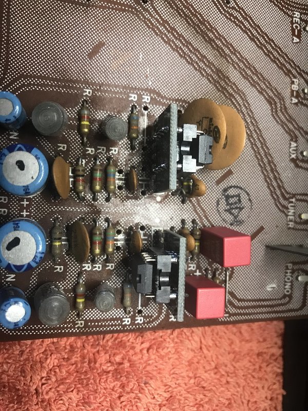

I had previously replaced the filter caps on this amp with the same size.
Next on the list was to replace the TA7136P op amps (SIL 7 pin) in the phono section, as well as the preamp section.
I replaced these with Burr Brown OPA604 op amps, to see if it would make any difference to the sound.
I used Brown Dog TA7136P adapter boards.

The OPA604 does not have a frequency comp or voltage comp pin, so pins 1 and 5 are not used.

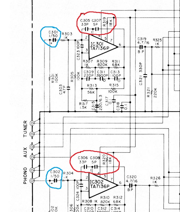

For the phono section,I removed C305, C306, C307 and C308 (Freq Comp), as these are no longer required, and may affect the circuit.
I also removed R319 and R320 (Voltage Comp), though they would not cause any issue if left in. I also replaced C301, C302 electrolytics with WIMA box film capacitors.

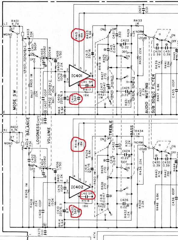

In the preamp section, I removed C411, C412, C419 and C420 (Freq Comp), as these are no longer required, and may affect the circuit.
I also removed R415 and R416 (Voltage Comp), though they would not cause any issue if left in.

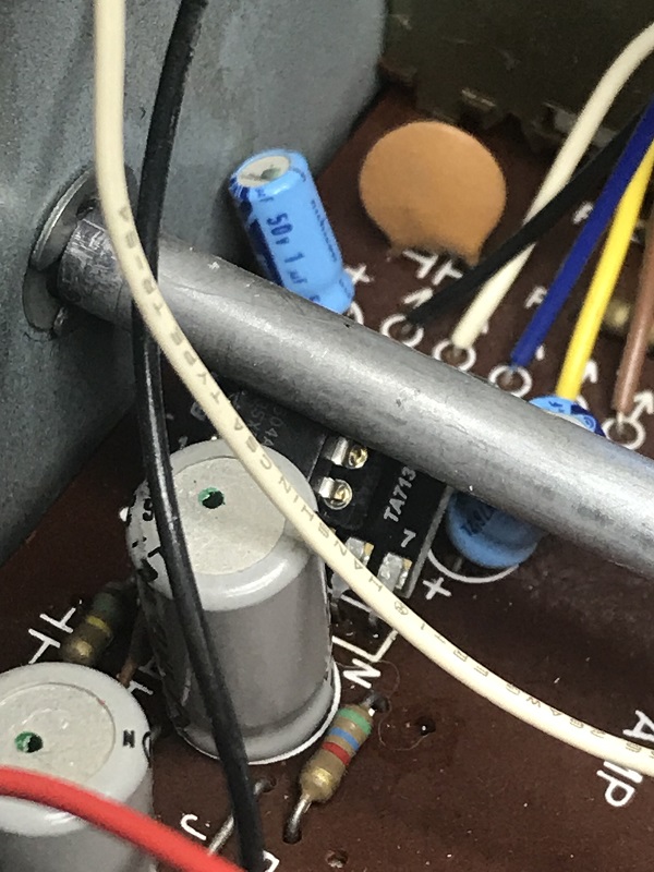

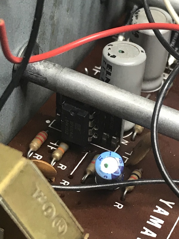

Of course, the original preamp op amps are right underneath the selector shafts, so it was a bit tricky to install the adapters. The right fit fine, but the left had to be installed with a lean on it.

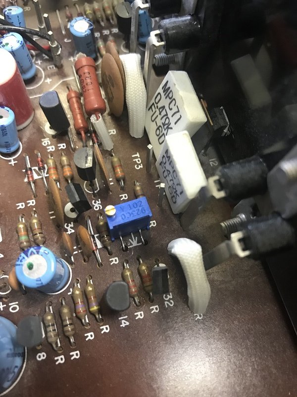

I also replaced the 1K bias trimmers with Bourns 20 turn 1K trimmers. Much nicer to adjust.

It is good practice to place a “decoupling capacitor” across the +ve and -ve supply of the op-amp, as close to the op-amp as possible, to reduce the chance of oscillation in high speed op-amps like the OPA604.
A 0.1uF (100nF) 50V X7R Ceramic is most commonly used.
Solder the capacitor on the back of the brown dog board between op-amp pins 4 (- VS) and pin 7 (+ VS).
Thanks to @zebulon1 for his thread showing these on the brown dog adapters here :-
https://audiokarma.org/forums/index...-now-working-and-sounding-great.707379/page-5
While I didn’t use them on my 610, and didn’t notice any oscillation, YMMV, and it’s worth doing while you are at it.

Unfortunately, after the last intervention dedicated to the replacement of electrolytic capacitors not replaced previously, to the replacement of the pot trimmers to regulate the quiescent current and to the replacement of the Phono pre IC my Yamaha Ca-610 is having a tantrum.
The R 526 / 1K resistor, which you see indicated by a red arrow in the diagram, heats up to burn out.
Of course and fortunately the relay does not trip, so the amp remains in protection.
Did you reset the trimmer to minimum resistance before power up?
Try power up with DBT, does bias respond to trimmer adjustment, eg, set bias low to 2-3mV...

Build a Dim Bulb Tester, it's a current limiting device, it will help prevent further damage, numerous plans on AK, google "Audiokarma Dim Bulb Tester build". It's basically an incandescent (not LED,,,) bulb in series with the mains active line.
no, unfortunately I have not set the trimmer to the minimum.
So, possibly the bias is set too high?
