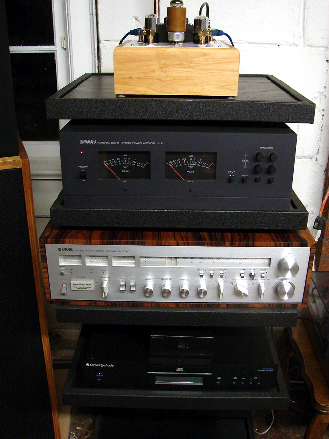

It seems this thread got resurrected somehow - I have a new shot for you guys. The 1020 shares a rack with a Yamaha B-2 and a Bottlehead pre.
Sorry to bump an old thread 3 years old.....but did anyone notice what’s WRONG with pic ? Man, your Yammie’s gonna get hotter than hell with the grill covered up down below. It already runs pretty damn hot around the power supply even not covered up. All my vintage amps runs on top of the heap !
Btw, i didn’t read anything about any mods. Did youdo the heat sink/Tip41C mod ? Better do it, otherwise the board gets so toasted as to darken around the 2 crappy original heatsinks.
Also, while you’re at it , replace the 3 fusibles on the electrolytic board (and lift them above the board).
