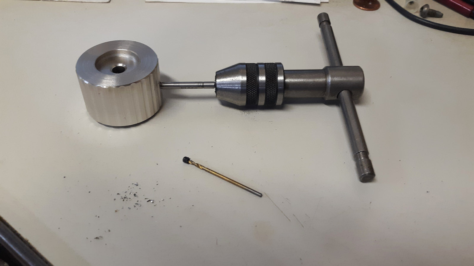

At the least, apply some anti-seize to the set screw so that it doesn't fuze into the aluminum. I JUST NOW finished drilling one out and tapping the thread back through (with a roll-form tap) to avoid having to step to the next size screw. I was thinking about this thread the entire time.
At the least, apply some anti-seize to the set screw so that it doesn't fuze into the aluminum. I JUST NOW finished drilling one out and tapping the thread back through (wil a roll-form tape) to avoid having to step to the next size screw. I was thinking about this thread the entire time.
I add a drop of clear silicone grease to the threads, then wipe off any excess. Aluminum galls easy and makes steel set screws "stick" in the threads. Either way, a thread "treatment" is good. :thumbsup:
