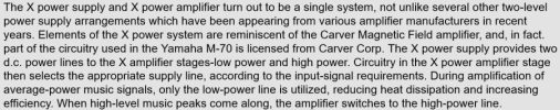

although ax-490 is not m-65 it does shed some light on a few things.
a few more pieces to this rather odd puzzle:
Screenshot 2023-07-10 at 16-12-06 Yamaha M-70 Power Amplifier (Jan. 1984).png
in regards to the m-70 design, licensed tech from carver.

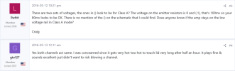

*although for the m-70, still interesting info when slogging through a persnickety quagmire of an m-65.
