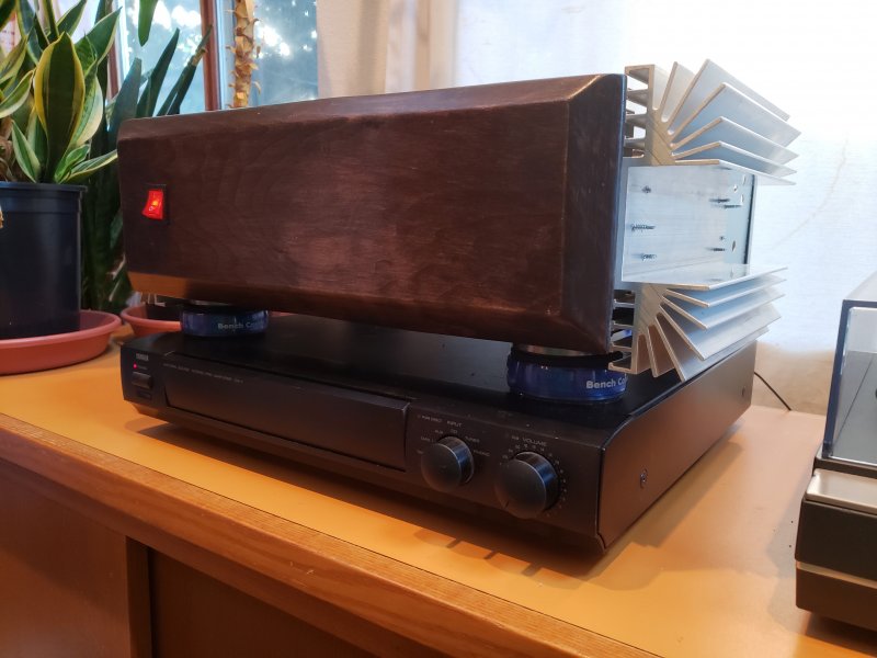

Since we already got off topic, my Pass Aleph 3 clone build went reasonably well. I have it set up with my Yamaha CX-1, Yamaha WXC-50, and Sony PS-X60. Sounds really nice come through my Klipsch Quartets! I got the heatsinks from the estate of James Bongiorno (on the bay). They were originally intended for a Sumo The Nine amp.
