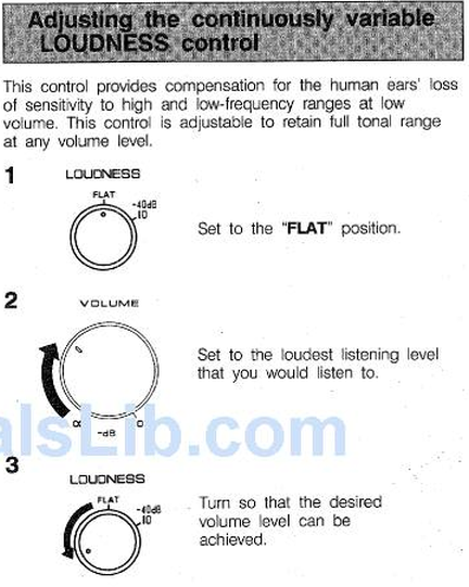

Loudness compensation instructions:
https://www.manualslib.com/manual/340448/Yamaha-Rx-950.html?page=9#manual

My question refers to the "continuously-variable loudness control." This manually-chosen loudness compensation is totally independent of the volume control position. No matter how high the volume control is turned, the amount of loudness compensation remains the same. Fine and dandy. I'd rather have it volume-dependent, but that's neither here nor there.
The real oddity here - and the point of my post - is that even though the volume control has no effect on the level of loudness compensation, the loudness compensation level has a big effect on the volume control. As the loudness compensation level is increased, the volume level decreases.
For example, when adjusting the controls as the instruction manual directs, I will set the volume control to approximately 1/4th of its travel, then adjust the loudness control. As I do so, the receiver's volume progressively lowers. By the time I've selected half of the available loudness comp., I have to raise the volume control to twice its original setting, going from 1/4th of its travel to 1/2.
So, is this normal for this kind of "continuously-variable loudness compensation?" Doesn't this design rather defeat the purpose of loudness compensation altogether?

The manual for the older Yamaha receivers say something about using the loudness control for the volume after the volume level was set.
I never liked Yamaha's loudness controls.
Rob
The idea was that you set your level for normal listening (9:00?) and then leave it there. When you want background levels, use the loudness knob to reduce volume. Idea was that the compensation would be appropriate for any level you decided on. You can always turn up the big volume knob.
I use the loudness control on my Yamaha amp slightly different than the recommended way. I set the volume to my desired level first (maybe a tiny bit higher) then only if needed, I will back down the loudness to where it sounds tonally balanced. I little goes a long way. After that small volume tweaks still have the same tonal balance.
Thanks for the replies, folks. At least now I know that the "problem" is not a problem.
This is the correct way to use a variable loudness control. Whether one likes them or not they are a tremendous improvement over the loudness switch. A loudness switch does not take into account how loud you're listening. They are generally tied to a 50% loudness tap on the volume control.
Consequently, an efficient speaker like a Klipsch which may be call the cops loud at 9 O'clock while an AR-3 may be just waking up. Does anyone really think they should get the same amount of compensation at any volume.
I use the loudness a little differently based on a suggestion from someone on AK. Loudness flat, turn volume to the highest level that you would ever want, i.e. rock-on dude level, then turn the loudness to reduce the sound level to what you desire at that time. If you want more or less sound level later just adjust loudness.
That's exactly what the manual says is the correct way to use the loudness control. I learned this long ago with an ARC SP-3. It also has a variable loudness control.

Remember: the loudness control is NOT a volume control; it IS an equalizer--does not affect volume, does effect frequency. Speakers all get the same info.

I sold Yamaha for over 20 years beginning when they first introduced the variable soundness control. It was just as confusing to me at first. I read the manual.
whoareyou99:
So then you agree the variable loudness control is intended to be used for volume control in normal operation, and that the "volume control" is only used to set the high limit, so to speak?
