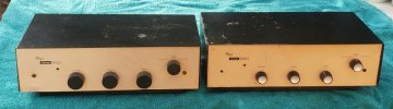

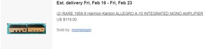

Ha! nearly 17-years later
I just bought another pair of these on eBay for only $119!
They a little rough but not too bad
Might just gut them and wire up a little SxS twin drive stereo chassis
