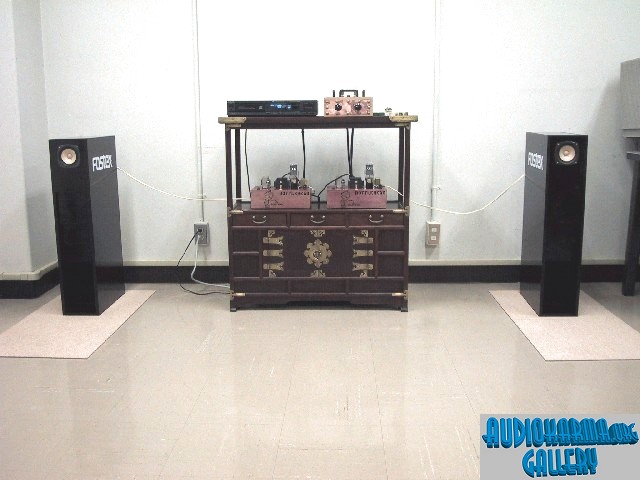

Hello All,
Here's my office system for work.
Bottlead Paramour 2A3 amps modified with 1.5uf Auricap Parafeed Coupling caps.
Auricap Coupling Cap
100uf Power Supply Cap Upgrade
Removal of a 270 ohm 5 watt Power Supply Resistor replace with a 270 ohm choke.
Scratch built copper top Foreplay with DACT attenuators and Auricaps and Anticipation Upgrade.
Star Ground Scheme
Fostex Recommended Back Load Horn design with FE-103M Memorial Edition Drivers painted in Polyurethane Black.
