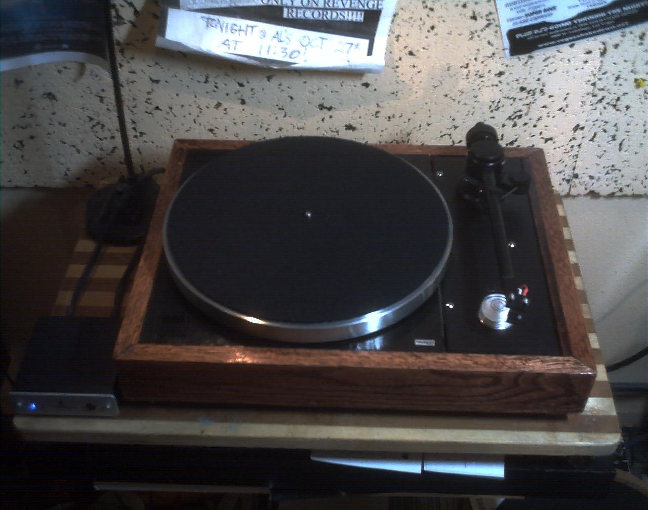

Thorens TD150mkII SE very modified
  • Media owner rkay5
SE is added by me
Oak phinth made Linn LP12 size
AudioQuest PT7 Tonearm mounted on a Linn LP12 armboard
Low Power 16V~motor PSU Pro-ject SpeedBox mkII
Linn Springs, Bolta and Grommets
Cork Damping of Main Platter, Sub-chassis and motor plate
Subplatter Dampin with .25"in mdf ring plate
Main Bearing has Hardmetal thrustplate and new Cemalit ball
4 3/4"in ISO Cone Spikes
