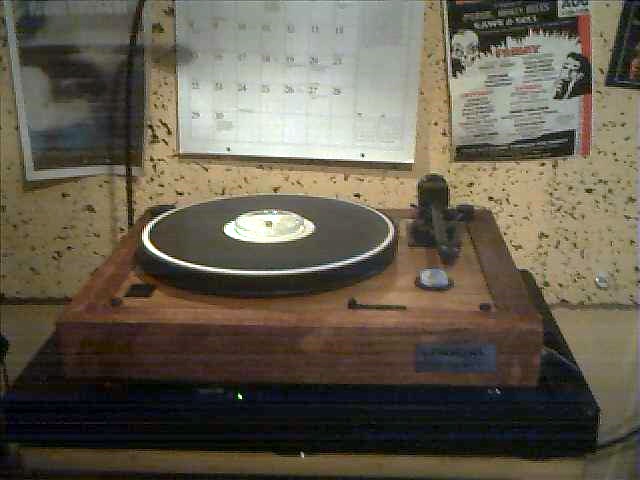

Thorens TD166mkIISE very modified
  • Media owner rkay5
Oak plinth,Oak veneer motor plate
16V~motor powered by Pro-ject SpeedBox mkI 50Hz/67.5Hz with up-grade psu 30VA Toroidal Transformer
Linn Springs and rubber grommets
AudioQuest PT7 arm
Clearaudio Aurum Beta S MM cartridge retiped by Sound-Smith with Ruby Cantilever & Nude Contact Line Diamond
Cork damping on sub-chassis and main platter
Dynamat on motor plate and MDF damping ring in the sub-platter
Black Diamond Racing Cones
Herbie's Way Better Turntable Mat\" 3mm
SRM/TECH Platter damping
