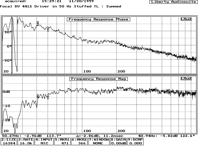

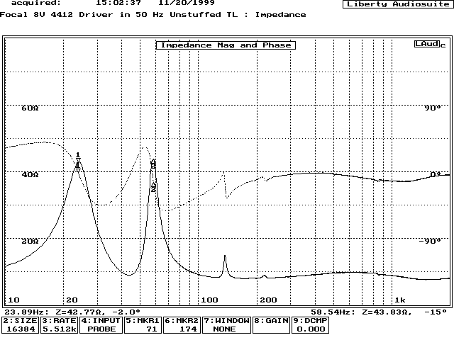

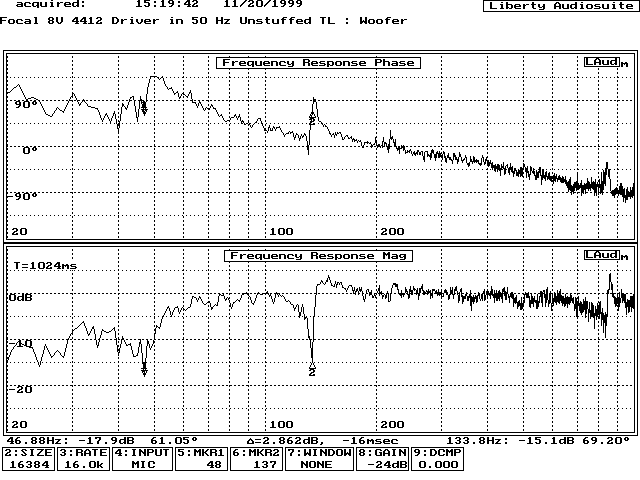

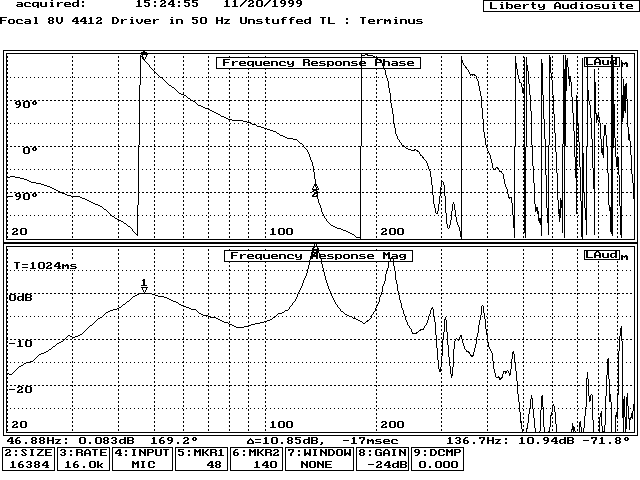

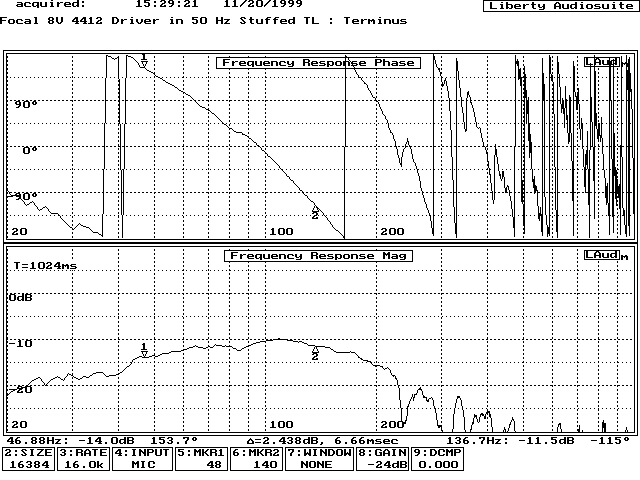

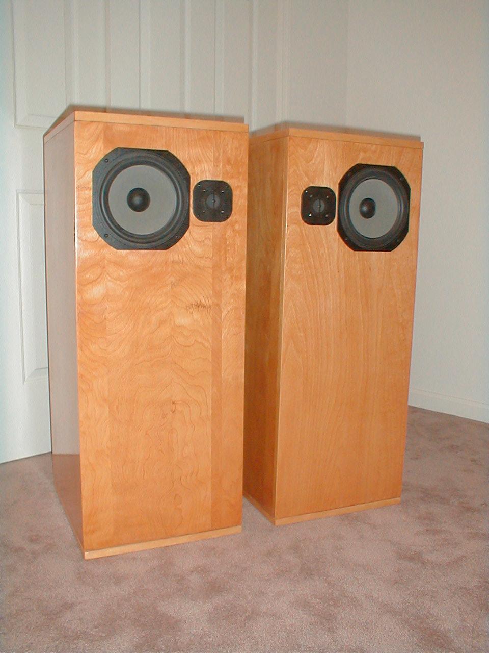

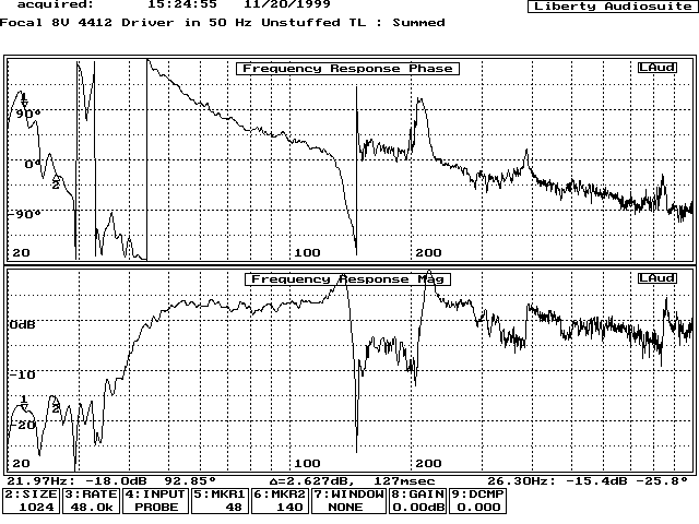

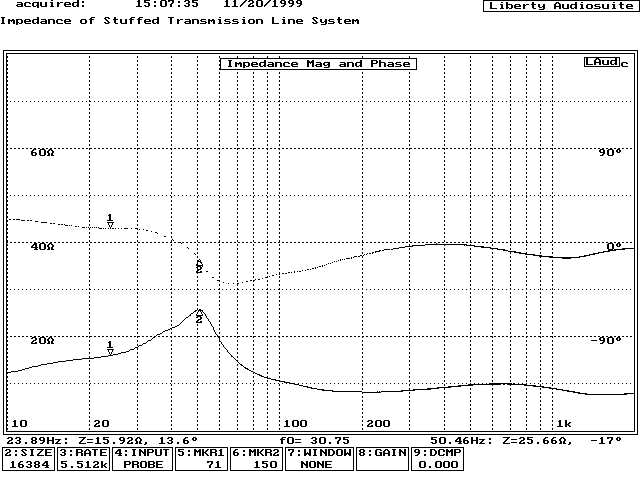

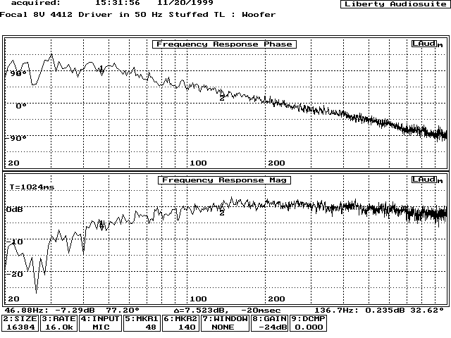

A straight TL I built about 15 years ago for a pair of Focal 8" mid woofers. The TL was tuned to about 45 Hz and the entire length was stuffed with ~0.5 lb/ft^3 of Dacron Hollofil II fibers (pillow stuffing). I eventually ended up with only the first 2/3 of the length stuffed. These are the empty and stuffed measurements of electrical impedance and the SPL for the woofer and open end. Comparing the two plots for each measurement you can see how a TL works and how the stuffing impacts the response.
Empty and Stuffed Impedance
Woofer Response Empty and Stuffed
Terminus Response Empty and Stuffed
Summed Response Empty and Stuffed
The measurements show that Dacron fiber is very effective (the first peak in the impedance curve is supressed) and that the TL behaves as it should. The higher order standing waves are damped out and only the fundamental contributes to the bass output. There is no phase inversion at the tuning frequency only a 90 degree shift associated with a quarter sine wave along the length. And the best part is that the MathCad models for this geometry and stuffing configuration correlate very closely to the above measured results. If you can calculate an answer that matches test data then you must have captured the significant properties/behaviors of the design correctly.

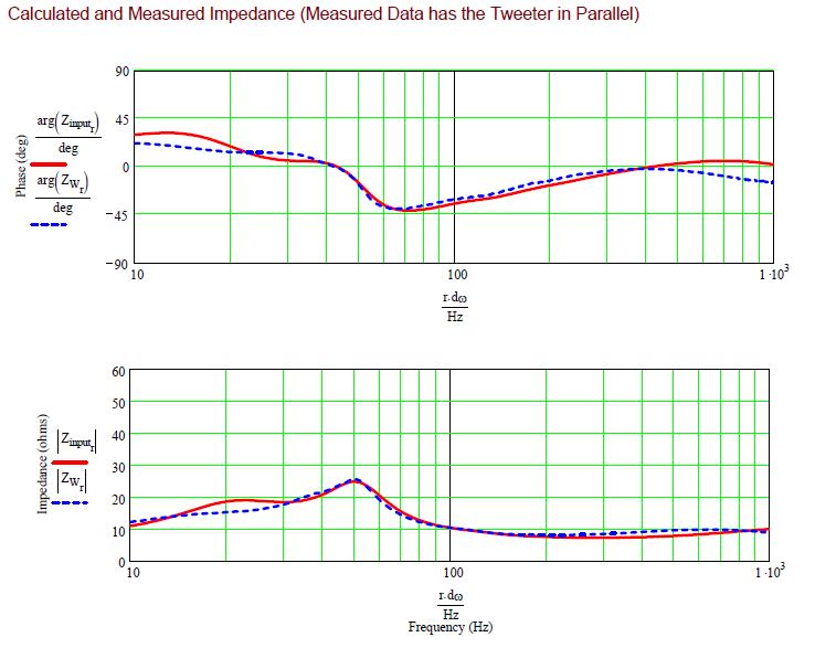

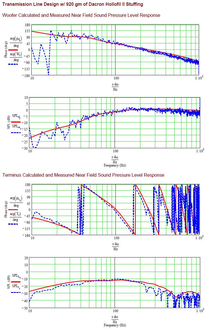

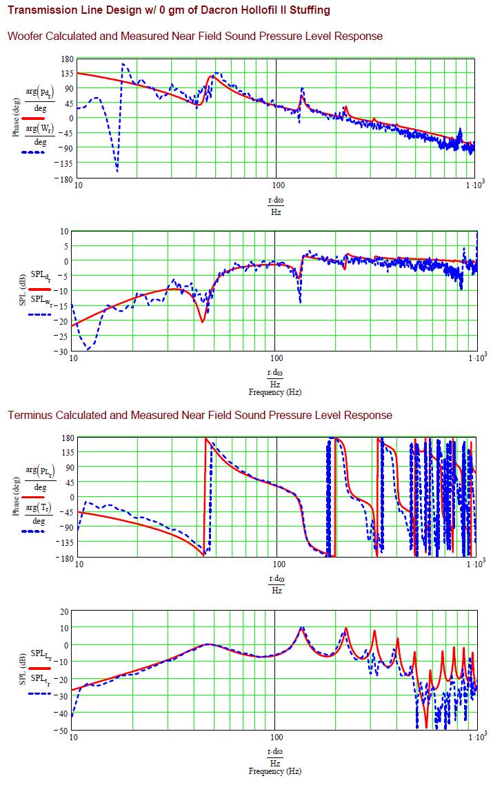

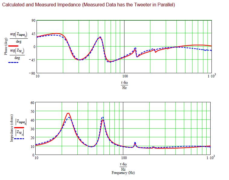

The test data from the previous post pulled into MathCad and plotted over the modeled predictions.
Impedance - Empty TL
Impedance - Stuffed TL
Woofer and Terminus SPL - Empty TL
Woofer and Terminus SPL - Stuffed TL
I believe the correlation is extremely good and conclude that the math/physics based MathCad model accurately captures the empty and stuffed TL behavior.
