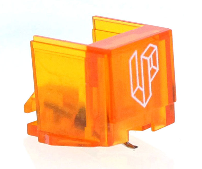

This one from LPGear?
How does it sound? Is there any info included in the packaging about the specs of the stylus tip?
Sorry for going a bit off-topic, but I've been fascinated with that LPGear stylus since I saw it, but importing it to Scotland would cost me an arm and a leg on top of it's sale price.

Yes, I have this one and lost my temper after I discovered the wrong azimuth (under my 10x loupe).
- the cartridge doesn't fit well into my 3600L cart on LP60x or another 3600L cart with headshell I put on my LP7 (i.e. I didn't feel the 'click' as I did with Conical / Elliptical replacement stylus)
- cantilever is just stuck into the suspension (I didn't know about it or otherwise I could rotate it to fix the azimuth issue)
- the screw could be loosen and 'release the suspension completely
I lost my temper and broke the suspension part. I wouldn't shop there anymore.
However I still have the Vivid line as part of the whole purchase in my drawer.
just to attach my broken ain3600slc as a proof of the ownership. the cantilever wasnt stick tightly to the suspension and i could rotate it freely. besides i recall the magnet was so close to the coils in my cart that ever stopped one side's movement such that no sound was from that channel.
in general i like 3600LC more than 3600LE for the cost and all rounder.

With a conical Azimuth does not really matter as a conical well conical and the tip is rounded so in correct azimuth you still wnd up with similar contact patchs so you have likely broke it for nothing.

The stylus that thw61 is referring to is LP Gear's AIN3600SLC, a $350 model that is described as having a "Special Line Contact (SLC) diamond tip." Being a conical user stylus myself, I appreciate your information that they are more tolerant of azimuth error.
