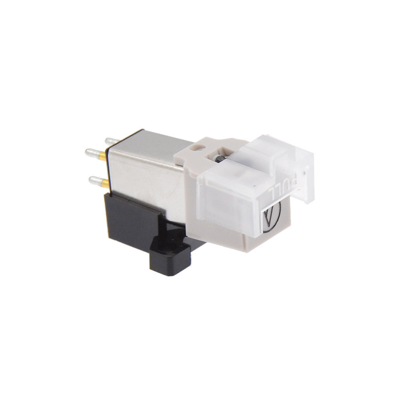

Great post and thanks for reviving this topic. I have one question, however. The photos for the cartridges sourced from Hong Kong look different than the ones I previously purchased from Chinese seller us-enjoy:
From one of the many Hong Kong sellers using the same photos as the listing you included in your post:
From the listing for seller us-enjoy:
Notice the difference in the way the stylus sits in the cartridge body? So, are there two different versions of this cartridge being sold by different sellers, or does the photos used by the Hong Kong sellers just show a stylus that is improperly installed? I suspect the latter, but would like to confirm with someone who has actually received one of these cartridges from one of the Hong Kong sellers that uses the photos shown in the listing you referenced in your post.
That definitely looks like improperly installed stylus to me. The dual magnet need to sit in the cartridge body's slot for the V shape magnet. If not, it would look like that in the photo.
You can try to reproduce the picture with your properly installed cartridge as well.
The first two photos are shown with the stylus not properly installed. They left the hook that is supposed to clip into the cartridge body hanging outside of it.
Thanks for the replies. I assumed the stylus was just installed correctly but wanted to confirm before pulling the trigger on a couple more.
Perhaps done simply as a way to display the full feature of the stylus, although it does allow for people to get the wrong impression and assume it looks that way when mounted
To me it looks like the top pictures show a stylus that is not installed at all, just sitting on top of the body
What wasn't obvious to me, from those first two photos was, is there even a slot in those bodies to accommodate the plastic tab on the stylus. If you look closely at this photo, you can see the slot in the body:
I'll just double check to make sure the styli are properly installed when they arrive. The first two I received from eBay seller us-enjoy had the styli properly installed, but they just came in little plastic bags, without the nice plastic box.
