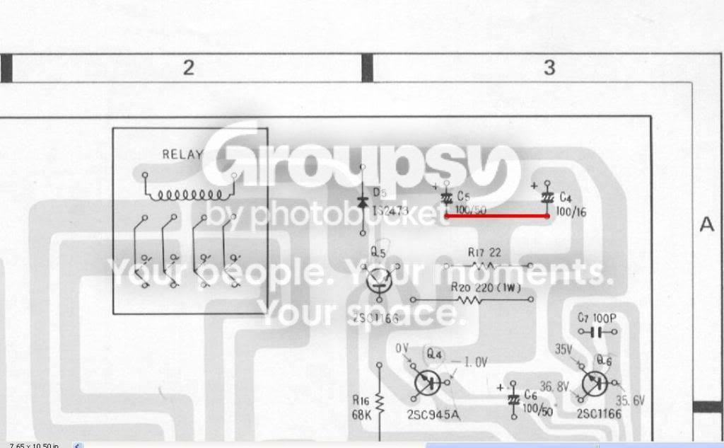

Alright I have hit a speed bump. I had some of the foil lift on one connection and am unsure what action I should take. I was thinking I could place a jumper between the two caps as represented in my picture. Is this the way I should handle the problem?
You try to put the foil back, and then clean the green paint off of it, and add the bare wire jumper soldered on the length of it, with the jumper and the component joints forming the strength to hold it in place.
