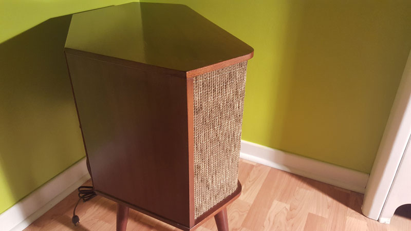

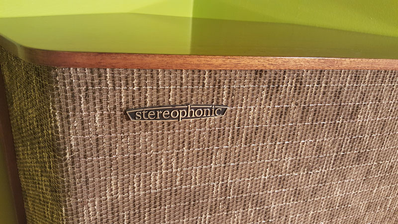

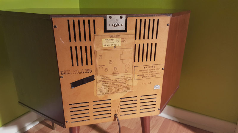

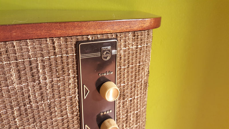

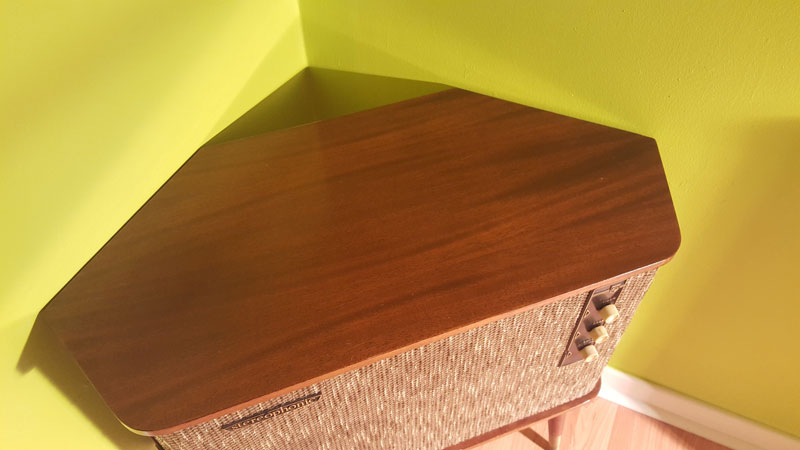

Hi all,
* * EDIT * *

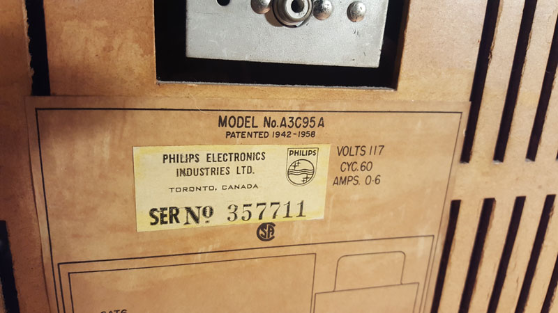

I misnamed this thread. I should have called it Philips AC395A Tube Amp / Speaker.
Philips
F5C10A refers to the console to which this speaker was a companion.
I'd like to share a rare gem and ask for some advice.
Backstory

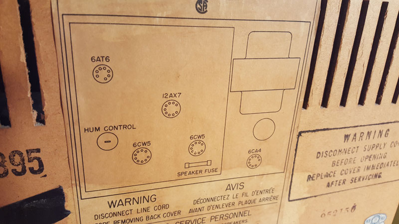

My grandparents bequeathed me their vintage "HiFi" radiogram* along with what I would describe as a 'satellite speaker'. Long story short, for various reasons I've decided to pass on the radiogram itself but I have taken possession of the satellite speaker.
Photos
Questions
I can't find any info about this speaker. I get the impression that it may have been a regional product... in other words, it was unique to the Canadian market and not similar to items produced by other Philips factories in other countries. But someone may want to correct me on this.
I also have the impression that a stand-alone speaker like this was a rarity in the late 1950's. Again, please correct me if I am mistaken.

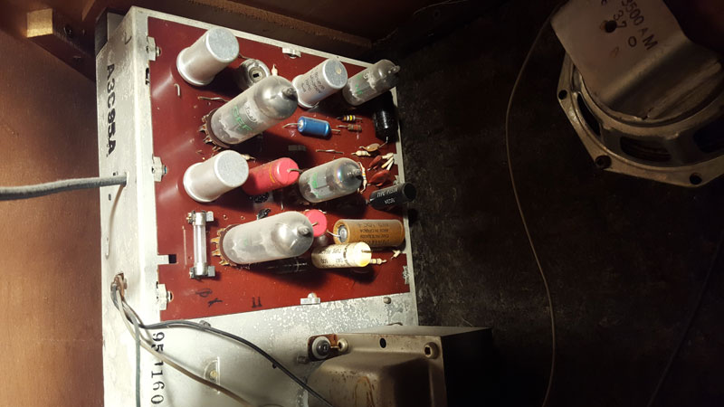

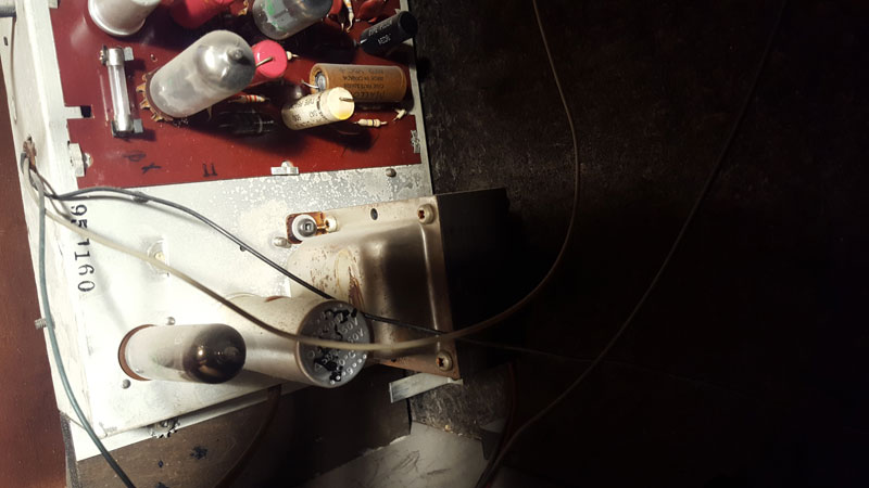

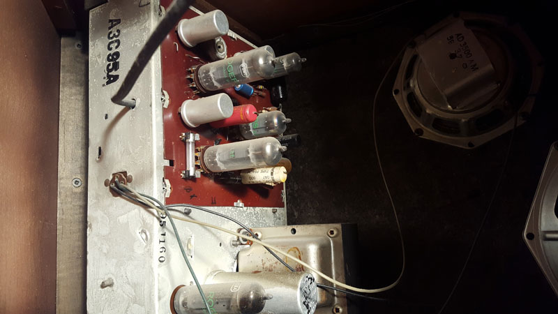

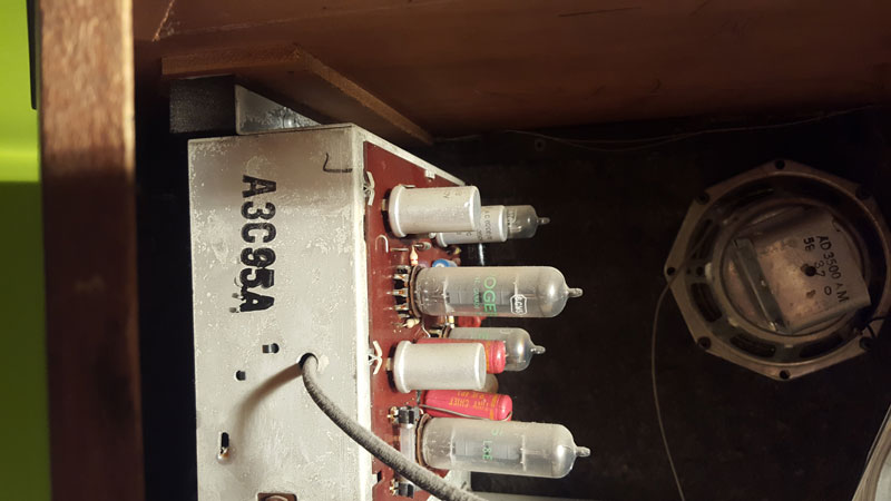

It is in amazing condition, but I am not going to take any chances. My understanding is that it hasn't been used in decades. I am going to have it looked at by a professional and have all tubes and capacitors tested and replaced as required. I won't attempt to power it up until it is serviced and there is no risk of damaging it.
The radiogram that this was paired with has a mono record player, a mono AM / FM radio tuner, a mono aux port and a single set of drivers. This speaker is also clearly mono. I find it curious, of course, that it is branded as 'stereophonic'. I mentioned this to an old-time audio guy and he said something like, "Ya... stereophonic mono." But isn't that an oxymoron?! Until I started trying to wrap my brain around this I had only every considered the word 'stereo' to be applicable to 2-channel audio, and I can't find any info online that sheds light on this late 1950's usage of the term.
What kind of sound quality can I expect from this?

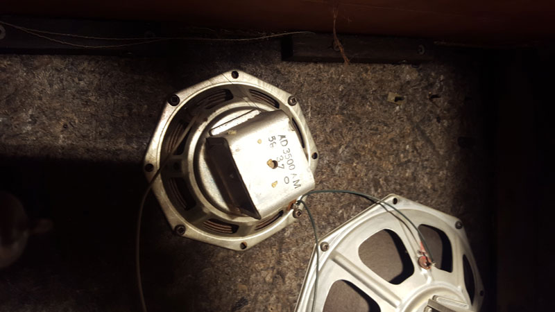

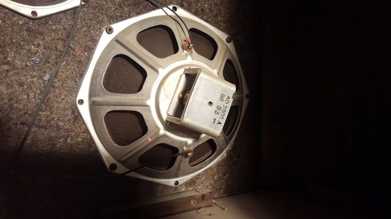

Is it a pretty safe assumption that the drivers will need to be replaced?
Even if the drivers are in mint condition, would a guy expect far better sound quality from modern drivers? Or is it ideal to keep the integrity of the components intact? I am curious to know everyone's thoughts on this.

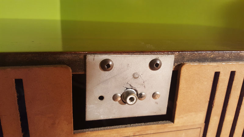

I'd prefer to mod this as little as possible, but there is one thing I'm really hoping to do (if it is possible). I want to replace the single RCA jack with a panel of various inputs to make the speaker as versatile as possible. Ideally, I'd like to have everything from a 2.5mm (1/16") mono jack connector to an XLR. I'm really hoping I can plug a guitar into this! Is this a realistic ambition?
*(From what I've been able to figure out 'radiogram' was the term used to describe what was later commonly referred to as a 'stereo console', but radiograms pre-dated the mainstream consumer adoption of stereo equipment).
All thoughts, explanations and ideas are welcome.

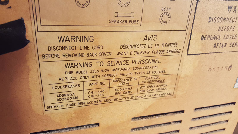

Is it that 800 ohm speakers aren't produced anymore?
Nevermind, I did my own research. It seems that high-impedence speakers were kind of a Philips thing, and rare even in that era; they are even less-suited to solid state and thus are now completely antiquated.
Yes it would be very hard to find anything compatible, If you aren't happy with it after rebuilding it, you could always convert it to a different tube amp and driver. Panasonic also had a similar impedance speaker arrangement

The drivers in the picture appear to be some nice alnico units which were common to low power tube consoles during the 50's and early 60's. They're often coveted by OB and guitar amp devotees. You can find similar drivers on eBay. My 12" Zenith alnico's pulled from a 1958 console shame most modern drivers. Can't see the cone but judging from the overall condition they're probably in good shape. They usually don't require reforming as the cone is robust and can extend to the edge.

I'd try to restore the amplifier in your extension speaker and keep modifications minimal and reversible. I've got a pair of those Phillips AD3800 in the 8 ohm version. They're quite nice for music, but I don't think they're up to guitar duty.
You can add greater flexibility by the addition of a preamplifier - you'll either use a mono preamplifier and stereo-to-mono adapters on your stereo sources, or a stereo preamplifier and a stereo-to-mono adapter on your preamp. I'd be tempted to go for a period-correct mono preamp. It'd match the speaker and, being mono, there are plenty of affordable options. You can then adapt out whatever kind of input you need from the multiple RCA inputs on the preamp.
Since the stock extension speaker has plenty of gain to work with, as well as tone controls, you could use a passive input switch box instead of a preamp. Realistic, TCC, Psyclone, etc. made tons of them over the years. Going DIY could be an interesting route, as you'd have control over the cosmetics and input jacks, as well as building your stereo-to-mono converter and balanced-to-unbalanced balun (if you need XLR) right into the box.
